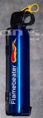

Chris,
I completely agree! I am thinking 10lbs and agree 3 nozzles, but I want two in the sills (one each) to keep the tanks safe. It is an enclose area on my car so suppression ought to be very effective unless it is completely torn open. Anyway, another in the engine bay. I am not too concerned with the front of my car as there is nothing to flammable up there anyway. Does gushing coolant work as a flame retardant? lol I am thinking about putting a hand held in the cabin. I found one with a lot of bling on eBay that would look good as well.
I assume you got the instructions for the group buy OK. Let me know if you didn't.

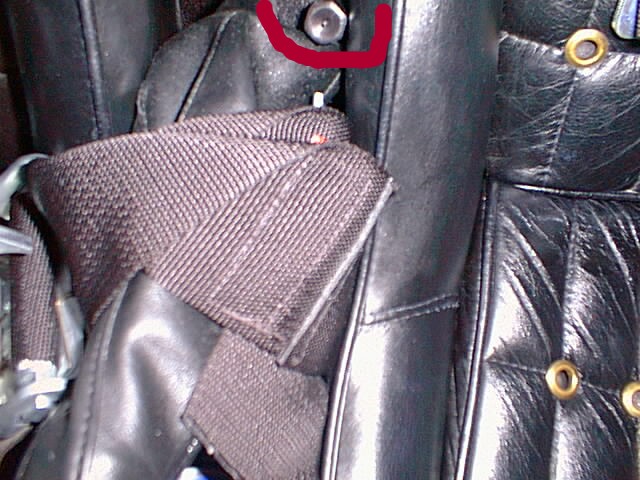

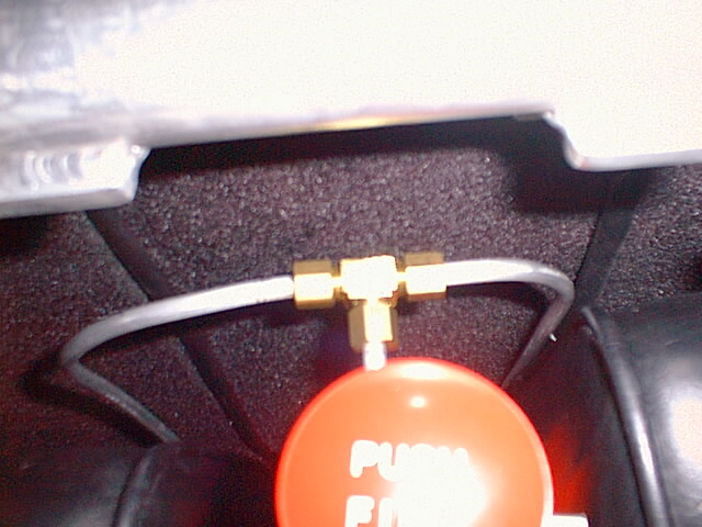

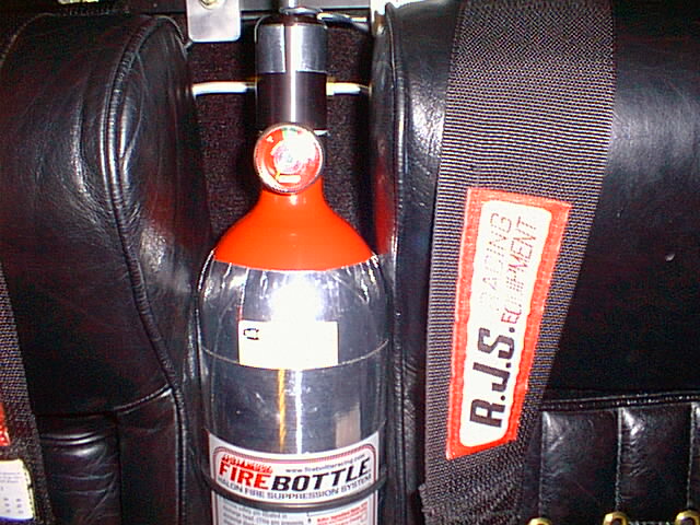

Lynn, My system uses CEA-614. This is the current replacement for Halon in newly installed fire systems. It is slightly more costly, aprox. 7%. What about the question about deplacement of air inside a closed cockpit? Here is what I think.
In the event of a fire that gets into the drivers compartment it is more than likely that the driver has already pulled the fire handle and started to get out of the car before he runs out of breath. This is a good thing because any product of combustion gasses or superheated air inside the car wouldn't be much good for breathing anyway.
If in fact the driver is trapped then cool halon that has no air in it will kill you as well as the above hot gasses/air. I think I would rather take my chances with the cooler option.
And, should the driver not be able to pull the fire handle.... Well on a track you have cornerworkers that will need a outside fire pull that is clearly marked. On the road....... Someone once said that when you are about to hit the wall pull the fire system. Ya right! Like I'm gonna remember that.
This is really one of those things that have no really good outcome except the fire system you install in the car will give you 5-10 sec or so to get the hell out of there.
Should you have a engine room fire it will of course save your car for you.
Put a fire system in your car reguardless of where you get it. 300-350 bucks is nothing compaired to standing on the side of the road and watching your car burn to the pavement.
My 5 pound system has one valve up under the dash pointed at the drivers chest and another in the engine room pointed at the top of the engine.
I hope I never use it.
