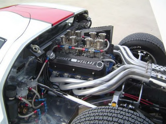

Hi Guys
I have just collected ten sets of Gurney Weslake replica valve covers five sets are already sold and shipped leaving five sets available. They are $400 a pair and $30 to ship to the USA.
Sold on a first come first served basis, email to melchrismelia@aol.com

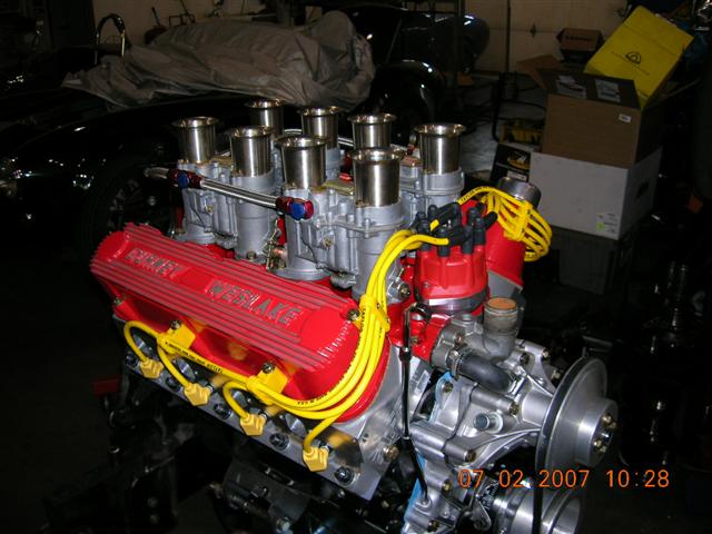

I bought a set of these covers from Chris and they are wonderful. They did however require some material removal for use with my AFR 302 roller heads. It cost me $60 to have them milled to fit. I powder coated them...see photo.

Hi Lynn
I like your treatment, your covers look great.
