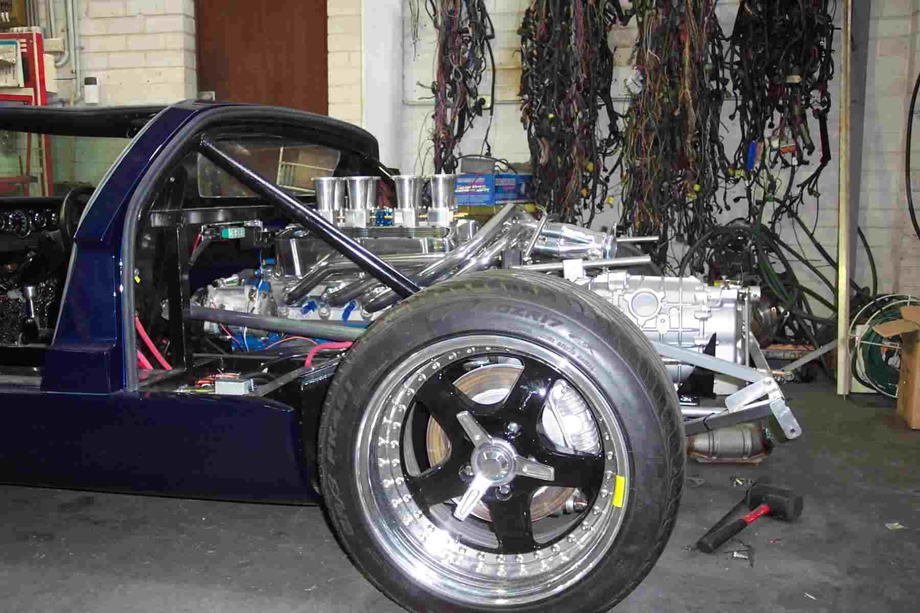

I'll throw a spanner into the spokes (so to speak) !
The standard setup with a DRB (GT40 Australia) is to use '87 Vette hubs/susp/brakes at the front & '88 Vette hubs/spindles/brakes at the rear. All hubs are set up for 5 x lug-nuts & nobody seems to ever have trouble with them coming undone. The problem is the "look" of the things.
Most newer DRB's are using 16" or 17" Simmons FR16/17 wheels & DRB is offering a very nice set of "fake" 3-eared spinners (knock-offs) for these. A threaded boss is mounted through the wheel centre, locked in place by grub-screws, & the spinner winds on from the outside. The nice thing is that there are 2 x LH thread & 2 x RH thread bosses/spinners in the DRB kit, so depending on your beliefs on this issue, you can put them on either side of the car.
Bill Bayard has come up with a "cover plate" concept which hides the lug-nuts (a plate held on by the fake spinner & which just covers the lug-nuts), so in conjunction with the fake spinners, the whole thing looks as original as you can get, but with the advantage that your wheels will not fall off.
The attached pic shows my wheels with the fake knock-offs - they will look much better when I get Bill's cover plates to hide the actual 5 x lug-nut setup.

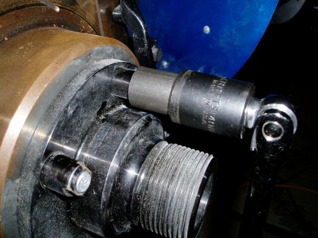

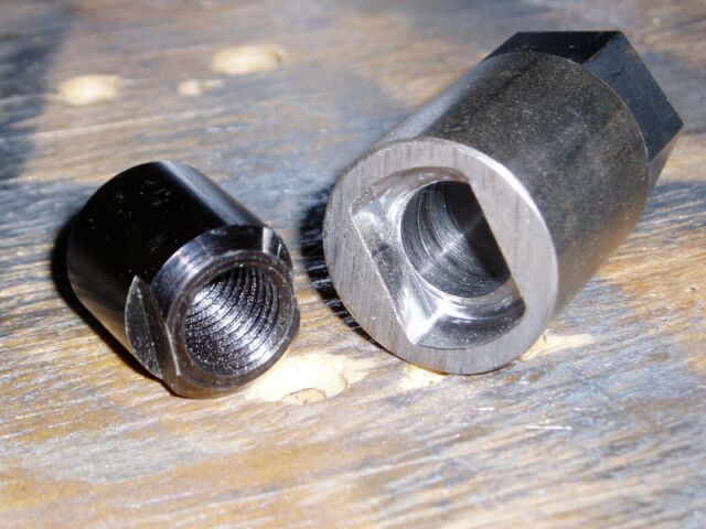

I had a local machine shop make me some adapter sockets that will allow me to torque these nuts with a torque wrench. I see this as a better solution than using an open-end or crow-foot wrench. Since there wasn't much difference in cost to make 10 instead of 1, I have a few extra for sale. I'll take a couple pics this weekend and post them in the for sale forum if anyone's interested.

Well, they're pretty good but they're not ready for prime time. I had 10 made and I was planning to sell them for $15 each (shipped), but the size of the hex head is a little weird. On eight out of 10 a 22mm is just a smidge too tight and 15/16" is loose, but torqueable. I'm going to take them back to the machinist and tell him he made me a bunch of parts that won't fit a standard socket and that he needs to shave a few thousandths off each one. One of the 10 is perfect at 0.868" between hex sides (fits my 22 mm socket perfectly); the others are more like 0.078-0.080". Hopefully he'll make good on his work and I can send these out in a few weeks, but he may tell me to pound sand. I've decided that I'm not going to send any more machining work to this guy.
I'll update this thread if/when I get these things fixed. Meanwhile, I'll post a couple pics. On the pin-drive-adapter-nut side, they're perfect. This will really make it easy to torque those nuts.

Here's another picture. I forgot to say these things are made of 1018 steel.
