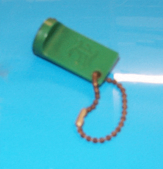

I can't get the locking wheel nuts off a car I've just bought. I've found the tool (the green thing in the pictures) but whatever I do with it, I cant get the wheel nut cover off. It rotates, I've tried tapping it in with a hammer but to no avail. Has anybody seen these before and how the hell do they work?
Simon

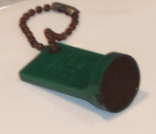

last one

Re: Locking wheel nuts....HELP!!
The plastic part may just locate on a cover plate which conceals the hex nut underneath. We had something similar
on a 4x4 Sierra and once the cover (which effectively just pulls off) is removed the 'combination' socket is then useable on the locking wheel nut. If its corroded, some heat, some plus gas, some gentle persuasion, then out comes the cold chisel.......
Not sure if its the same but I saw something similar once that was magnetic in some way. You pressed it against the head of the wheelnut cover with one hand, whilst pulling the cover with the other. The cover then came off to reveal a wheelnut on which you could then fit a socket.
Never know - worth a try? [img]/ubbthreads/images/graemlins/confused.gif[/img]

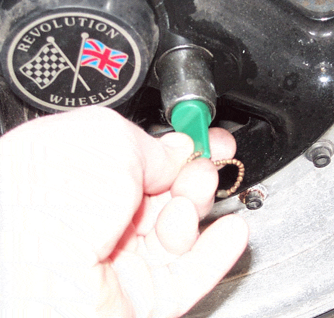

Hi Simon
I'm pretty sure that these locking nuts are standard Revolution accessories.
Check out the pesky little green keys on the following image:
I bought a set of wheels from Tyre Save, who stock the whole Revolution range. They should be able to help with a new key if needed.
Tyre Save Revolution page
Good luck
Rob

Thanks guys,
I've had an email from the previous owner letting me know how they come off but I've an idea the're rusted up, I'll give them another try this morning now the WD40 has had a chance to seep in.
Simon

Sussed it!
It's a turn and pull thing. One of them stuck fast so had to be "persuaded" with a hammer.
Thanks guys
