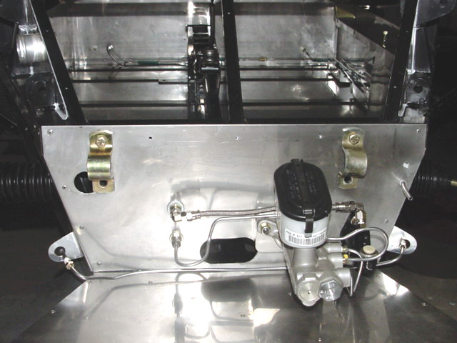

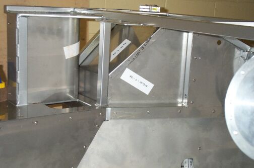

Does anyone have a picture, or pictures, of their frame with SSTL panels in lieu of aluminum panels installed? I think I read somewhere that Hershal used SSTL panels on his RF.

Bill,
Here is a picture of my chassis in the paneling stage.
I used the satin finished stainless insted of the shiney stuff.

Old 03-15-04, 03:42 PM   #3 (permalink)
Hershal Byrd
Location: Phoenix
GT40: RF
Posts: 1,262
Rep Power: 19 Hershal Byrd is on a distinguished road
Re: RF W/SSTL Panels
Another
File Type: jpg 33588-Master cylinder and front bulkhead.jpg (94.3 KB, 53 views)

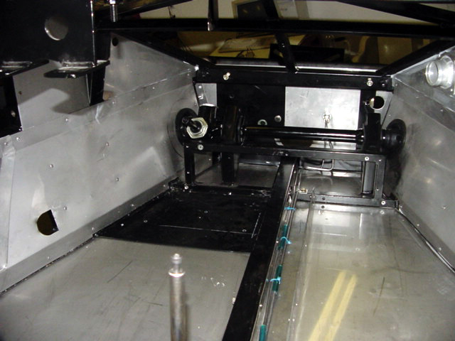

Bill,
I also went for the SS option with a 2B finish and I am very happy with it.

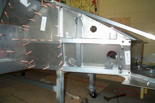

And another.
File Type: jpg 33603-P - 013 - Wheel Arches Inside.jpg (23.1 KB, 46 views)

Thanks Peter and Hersh. I am leaning towards a silver powdercoated frame and highly polished (mirror finish) SSTL panels. I feel this will give the look of a complete monocoque chassis. And the looks should be stunning.
