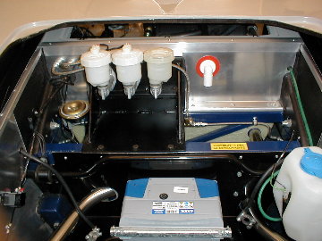

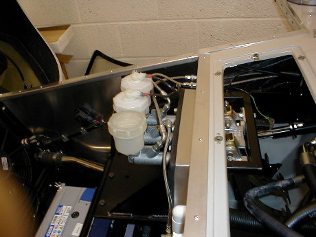

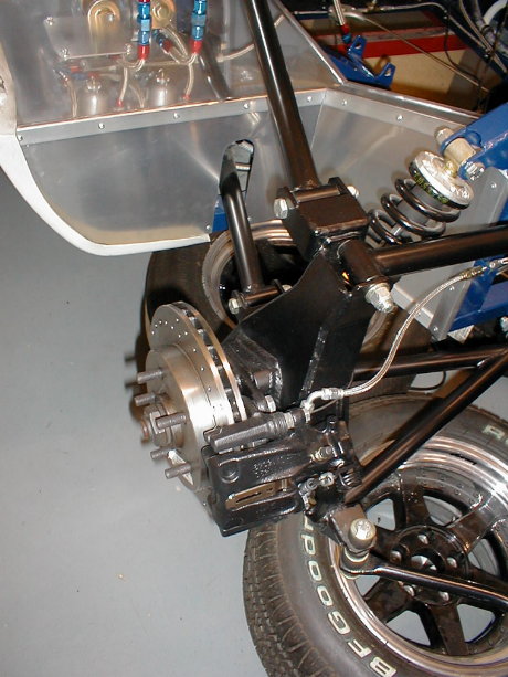

Hi Paul,
having been along the same road as your self overhauling callipers,I believe for the extra cost involved its proberly a safer bet to use new or factory reconditiond units.there are some quite resonable uprated brake kits available,I use a Cosworth rear calliper with 265mm vented and cross drilled
disc.avalable from Parallel Designs (www.Paralleldesigns.co.uk)The front callipers are wilwood Dynalite 4 Pot,with 285mm vented and cross drilled disc,avalable from Hi-spec Motor Sports (www.hispecmotorsport.co.uk.
all the very best with the build,
Brian Durbridge,
see attachment.

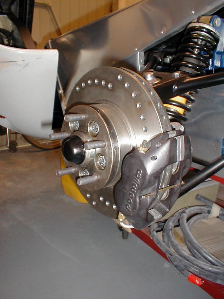

GTD Front 4 Pot Caliper Wilwood Dynalite.285mm disc vented and cross drilled.

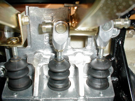

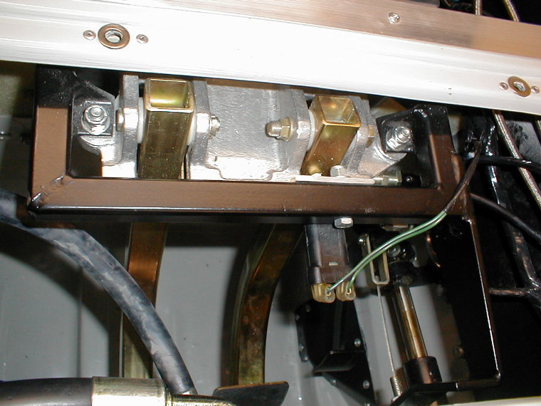

Hi Tony,
tilton box view from top and bottom,if you would like to see the box fitted,I am only 30 minutes down the M40from you,
Brian.

Tilton Pedal Box

Brian, I look with great interest at Your GTD/TILTON setup. I have one of the GTD units and would like to know the part numbers for the Tilton pedal assembly and the 3 master cylinders used. Also could you tell us how the gas pedal is mounted and how do you like the performance of this unit, not using boosters?
40bud is offline
Old 04-13-04, 04:10 PM   #11 (permalink)
breeze
Join Date: Mar 2004
Location: Oxford England
GT40: GTD 40
Posts: 29
Rep Power: 5 breeze is on a distinguished road
Re: Granada scorpio caliper overhaul.
Hi Bud,
the gas pedal is bolted through a bracket mounted on the side of the pedal box,the master cylinders are Girling brake master .75 / Clutch .70.the tilton box was purchased
from G.T.D there is no part number on the unit.the brake system was copied from another gt40 which the system worked very well,as my car is still in the building stage time will tell,
