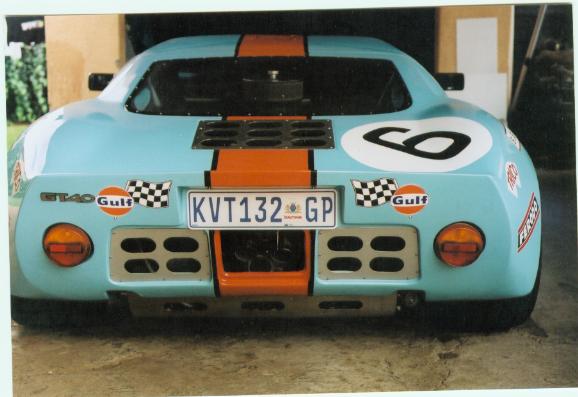

I'm running 305/50 X 15 on my 40, I think the profile etc is IMHO one of the best compromises between looks, handling and ride comfort. - Heres a pic of how mine look on the car with gulf flares - got the tyres from GT40 Developments South Africa (BF Goodridge Radial T/A)
