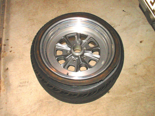

It’s interesting that the subject of tyre condition should be raised. A week-and-a-bit ago, one of the rear tyers on my GT40 self destructed while traveling along at 100km/h. I felt a short vibration and then a BANG! I was fighting to keep it in a straight line. On inspection, I discovered that the tread and tyre-wall had totally separated. (Not obvious in the pic, but it is all the way around). The tyre dealer is insisting that I had run the tyre totally flat for about twenty kilometers, which is almost laughable.
Has anybody else ever experienced such a failure?
PS. Although I am not dismissing out of hand that I may have had a half-flat tyer, I can say that fifteen minutes earlier I had six observers looking over the car and no one made any mention of a flat tyre. Sixty seconds before the actual event, I had taken a long sweeping corner and the car was as steady as ever.

JP, 35 psi Rear, 28 psi front

If you had run the tire flat for 20 km, it would not be on the rim, and most of the rim would be gone also. You should contact the manufacturer of the tire. That looks like a manufacturing defect to me.
In the U.S. we had the whole Firestone ATX recall, but that was caused by overloaded SUV's with low tire pressure. A light weight GT40 with a wide tire should be very easy on the sidewall, even with low pressure.
Your GT40 probably weighs a lot less than some cars that use that same tire, probably by about 2/3. So you could run 2/3 the tire pressure of that heavier car with the same ammount of sidewall deflection. I don't think you would be in any trouble unless your pressure was below 20 psi or the tire was defective.

The only reason a tire would do that IF IT WAS BUILT CORECTLY is if the tire pressure went way down. Thats what they look like, tread seperated from the side wall. That area of the tire is where it is flexing thus the heat build up and failure at the same point. Less than 5-10psi will do it. I had a suv tire on a Chev Blazer do the same thing and the tread came all the way off the tire leaving the sidewalls on the rim. I was in the SNOW speed about 40 mph and outside temp at about 15 dergees F. I first felt a slight softness then a slight vibration and BANG the tread was behind me in the rearview mirror. All in about 30 sec.
When I figured out what had happened I just let in coast to a stop and the rim, alum, was fine. I'm glad you didn't brake hard or you would have flat spotted the rim. All the keep it straight wide eyed arm motion kept you foot off the brake and saved your rim.
I would never believe this story if it had not happened to me. I still find it hard to believe that a tire could get that hot in those conditions. Oh the tread had a nail in it when I walked back and got it. I am not sure how long it ran with a low pressue but it felt ok up to the last min or so.
A light car might not warn you as to a low tire pressure as soon as a heavy one at speed. And as for looking at it sitting in the pits I don't think you would see a low profile tire that was down to 15-20 psi unlees you really were inspecting it. You may have gone out with a leaking tire and it just went down and blew up. These cars handle so well at 8/10s that you might not feel it.
Then again it might have been a bad one, it happens. Any holes in it?

The tyre is currently with the manufacturer and a written report will be provided so I shall wait and see. With regards to a hole in the tyre, the dealer said that he found a “big” hole that I couldn’t find.
Interestingly, the rubber adjacent to the failure point looked very fatigued, whereas the corresponding location on the other side of the tyre looked almost new apart from a little surface smudging from the rims. Should I expect that a flat tyer would have fatigued both sides of the tyre similarly?
