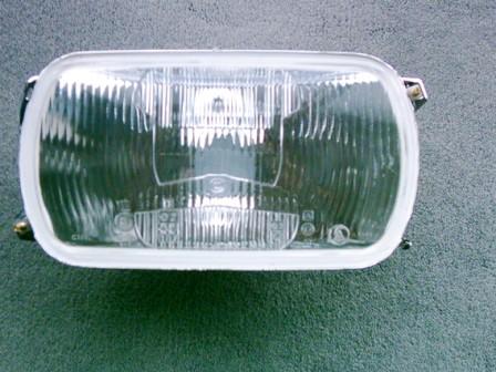

And the Valeo/ Cibie unit very similar to the originals is Valeo part number 470078. This is available from all good Valeo stockists. For example Central Auto Supplies. I got mine for £63.04 each +VAT. It is stocked at Valeo's warehouse in Birmingham, and at the factory in Belgium, and is still a current production item, although I have had absolutely no luck identifying what it was fitted to. It does not appear in Valeos catalogue, and has not done so for a few years. Even Valeo factory in Belgium and Valeo technical in Birmingham could not tell me what it was fitted to. It is suitable for Left Hand and Right Hand Drive, and uses the older style of H4 bulbs, and does not have a sidelight

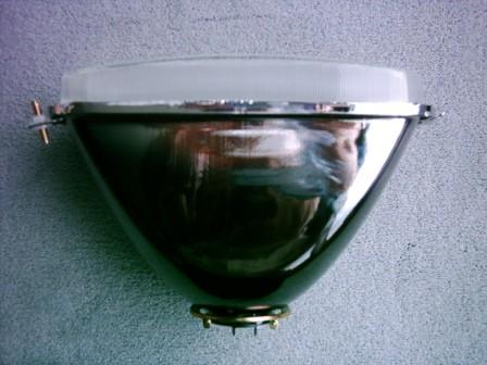

Re: Headlight Options
2nd picture

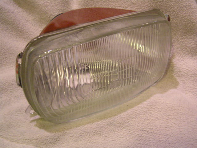

Gents
These are the units I use, Renault 12 sourced. Currently I am using a European spec lamp, But I think I will soon have units to take an H-4.
Phil
