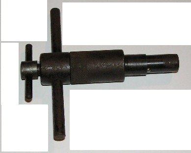

It is called a Crox tool. The small handle pushes a ball bearing out into the tube as the tool is rotated with the larger handle. The Depth into the tube is adjustable. The outer adjustable sleeve is touching the ball in the photo. ( it is spring loaded). One tool does one size tube. Dont know whether or not you can still buy them. I have from 5/8 to 2"

I know Earl's sells that type of tool, but nothing for 2". Did a web search for Crox with no luck, so no good there.

Earl's sell individual dies, here in the UK they are 70 + 17.5% tax for the 1 1/2. A complete kit is over 400.

Thanks Brett. I thought they didn't have larger sizes. One tool os all I need and that is worth the money to me.
