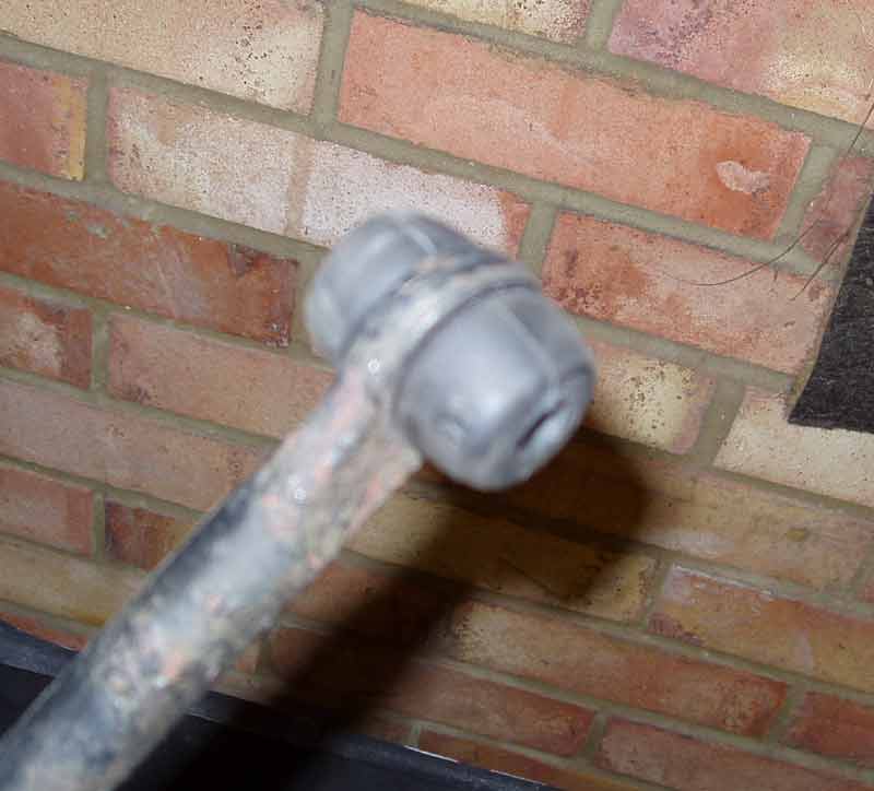

These are ford items I know, but can anyone tell me the part number or the car they are off please?
see pic (sorry for the poor quality pic)
Simon

Simon,
These are coming from a Ford granada mkII.I ordered full set for both front sides and paid arround 65 Euro.
Let me know if you need more info as I could ask part number to my local garage who supplied them.
Rgds
Fred

Simon,
Brown soap or something similar (the old mother prescription) but if you do not need them anymore , use a knife...
Fred

Hi Simon
Re the rollbar fittings you show - I believe you require the following:
2 x 1481463 Ford rubber bushes.

Thanks for all the posts.
I've got the parts powdercoated and a new set of rubber, but can I get the bl**dy things in? NO
I've heated,cooled,squished rubbed washing up liquid all over them but they still wont budge....any ideas?
Simon

Re: GTD Anti-roll bar mounts
I've used a 3 leg gear puller to get sierra suspension bushes in. But the shape of that anti roll bar arm, and the difference in size of the hole with the OD of the rubber makes it look very difficult. My guess is that you may need to use a bench press for that one, and maybe you will need to press the rubbers into a steel tube first, then press them through into the anti roll bar.
Cut them in half and then fit in the normal manner. The small area of rubber that passes through the bar does nothing except hold it all in place when dismantled. And cause you grief of course! The after market kits I mentioned above come in two parts per fixing.
