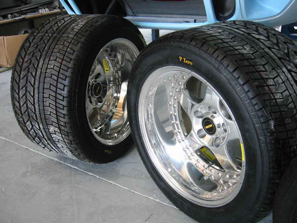

Bill, It may not be relevant in the U.S. but I am have bought Simmons three piece wheels.FR17x8 front and FR17x12
rears. Tyres are Pirelli P zero"s.
Simmons have a very good reputation in OZ for both road and
race use.

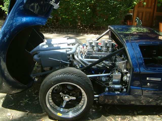

Like Pete, I am using Simmons FR17 3-piece wheels (although only 10" in the rear). I went for black centres to somewhat hide the more "modern" spokes & so that the fake spinners stand out a bit in contrast.
I am using Falken 235x45x17 on 8" rims at the front, & Falken 275x40x17 at the rear. Next time round, I'll up the size of the rears to 285's.
