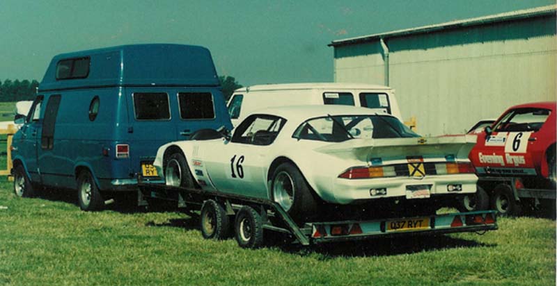

Phil, I just wonder how it now handles on the straight? I had a similar problem with the Penske Camaro and when I reduced castor to aid turn in, it worked a treat but became a handful on the straight especially on bumpy tracks where it tended to follow every line and groove in the asphalt. Found I couldn't roll a fag on the Hangar straight at Silverstone any more, and I missed my nap as well. Bugger! [img]/ubbthreads/images/graemlins/crazy.gif[/img]

PS Penske IROC Camaro "resting" at Goodwood together with Trans Am.
