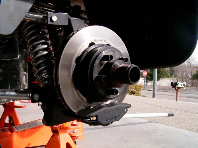

I have my wilwoods on my car and have sorted out the front to rear ballance issue. All is well with putting a proportioning valve into the rears. I did hit the curb doing some brake tests last weekend. Nothing serious but I had to take the whole front off to put the "horns" straight again. Those would be the 1 inch square tubes right in front down low that mount the front bodywork.
I still have the almighty squeal. So what should I use for brake pads on the street. I have c compound wilwood pads on the car now in Superlight 2A calipers. I have been told that Q compound would be better. Any ideas as to a favorite brake pad of yours for the street.
I'll try you anti squeal pads when they arrive Frank. Thanks again.

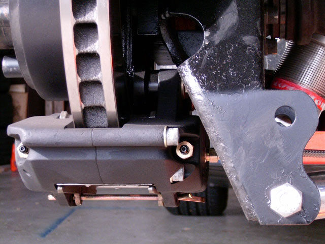

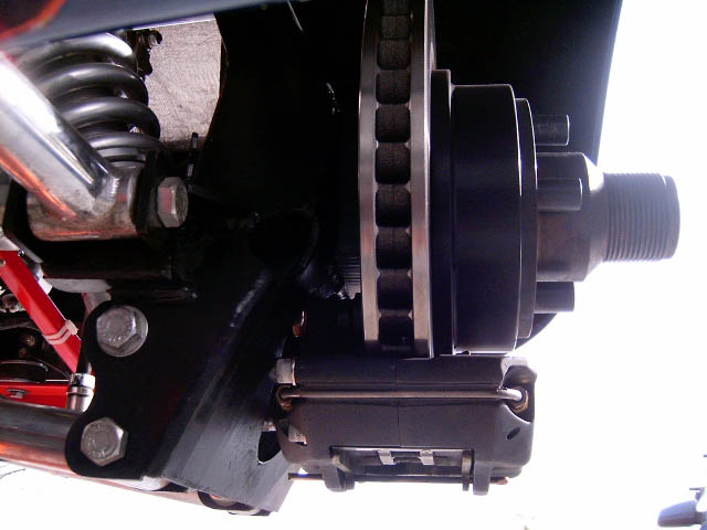

This is a wilwood hat that comes undrilled. I just drilled it for the GTD bolt pattern. In the end the fronts required a 1/16" shim between the hat and hub to get correct caliper to rotor alinement. Otherwise a perfect fit.

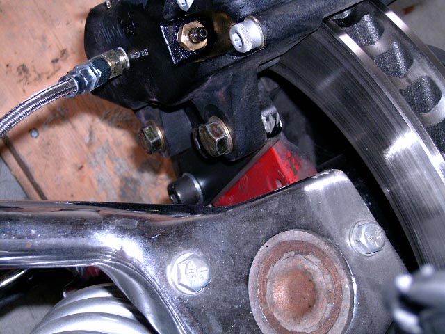

Another, 12.13 X 1.25 wilwood HD48 curved vane rotor and superlight 2A caliper.

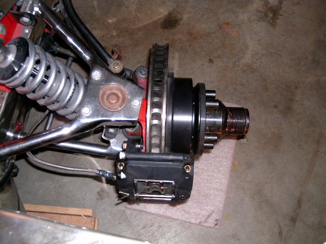

Shot of caliper bracket. This shot also shows the end of the hose. I cut off the orginal metric fitting that came with the GTD granada caliper and put on a standard USA AN3 steel brake fitting.

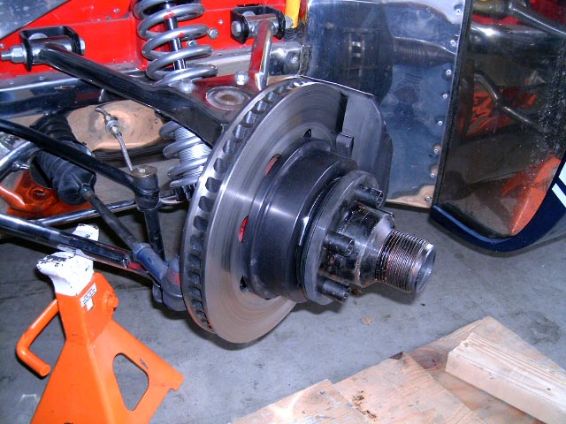

Rears

another rear pic

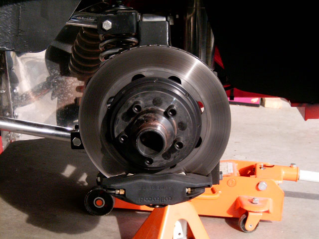

Last one

Last last one

Interesting to see you have your rear calipers underslung like the earlier GTD solid rear disc brake set up. I assume that is what you previously had. No wonder you feel a big improvement in stopping power! Howeever do you still have fun and games bleeding those rear brakes?
Malcolm is offline

I was also going to remark on the fact that the calipers are mounted at the bottom - very Formula Oneish! Did you do this to keep the CG as low as possible? I've also heard it's difficult to bleed the system in this configuration.

As to bleeding the rears, The caliper needs to be unbolted from the adapter and swung up to vertical. This is something that is added work but to mount the caliper on the top would have required cutting out a notch in the upright. A front or rear mount would have needed a much more extensive adapter. Again a money issue. Its OK I don't need to bleed the brakes all that offen anyway and when I do I just swing them up like I did the old GTD ones.
