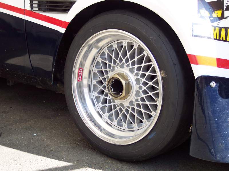

Guys,
Would you know were to find such design (BBS doesn't sell them anymore), centerlock or PCD 5 x 120, Ø:15"
off set on request. I would prefer avoiding Image and Compomotive ...

Sorre - slow computer - NOW I got the picture - No idea at the moment but I´ll check with some freinds that race two 962´s.
Henrik

Henrik,
As i can see we like and own the same cars ! I am rebuilding a CLS Grp 5 and the wheels are missing ... [img]/ubbthreads/images/graemlins/frown.gif[/img]
