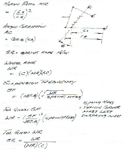

Useful formulae
Ls and Lb are the TRUE radii of the wishbone
spring shock normal (90º) to the plane of the lower wishbone
Name:	Spring and wheel rates.jpg
Trevor Booth,
Finished assembling a pile of bits incl, mono, 302W on IDF's,ZF, 15" pin drive BRM.
nota2266 is offline

Thanks Trevor. What is "C" in the formulae?

C looks like lower shock distance from inner pin.

oops, attempted to make them easier to understand!!
WR=(SR)(MR)(AC)
SR=WR / (MR)(AC)
Sorry
