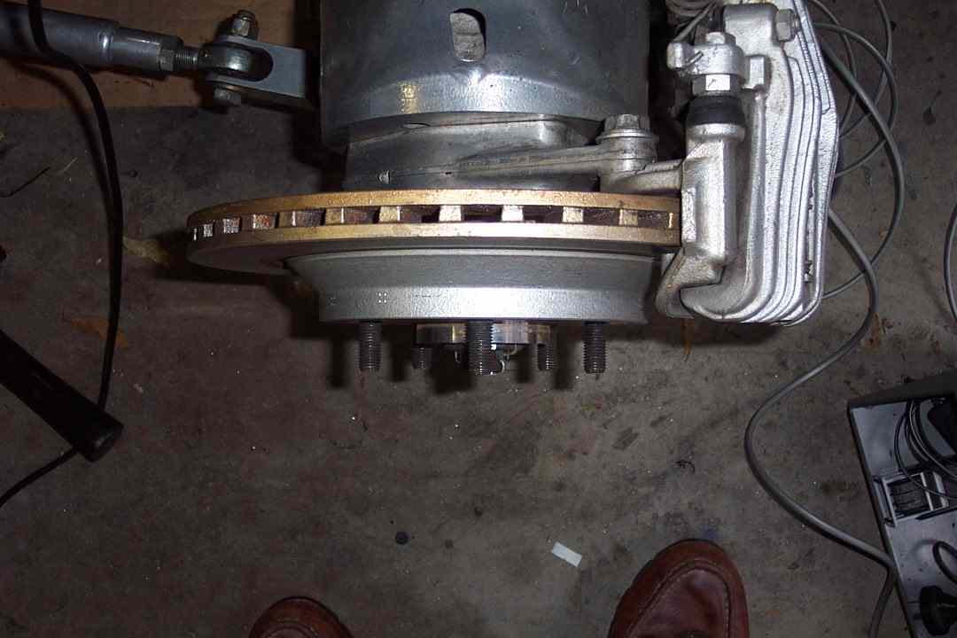

Mike - some more accurate dimensions & a pic :
- From plane of the rotor / wheel centre mating surface out to the outer-most point on the calipers = 5mm (so a recess of 1/2" should give you plenty of room).
- From the centre of the spindle back to the point on the calipers furthest out radially = 180mm (this is the slight "hump" on the caliper approx in line with the outer face of the upright itself).
Kiind Regards,
Peter D.

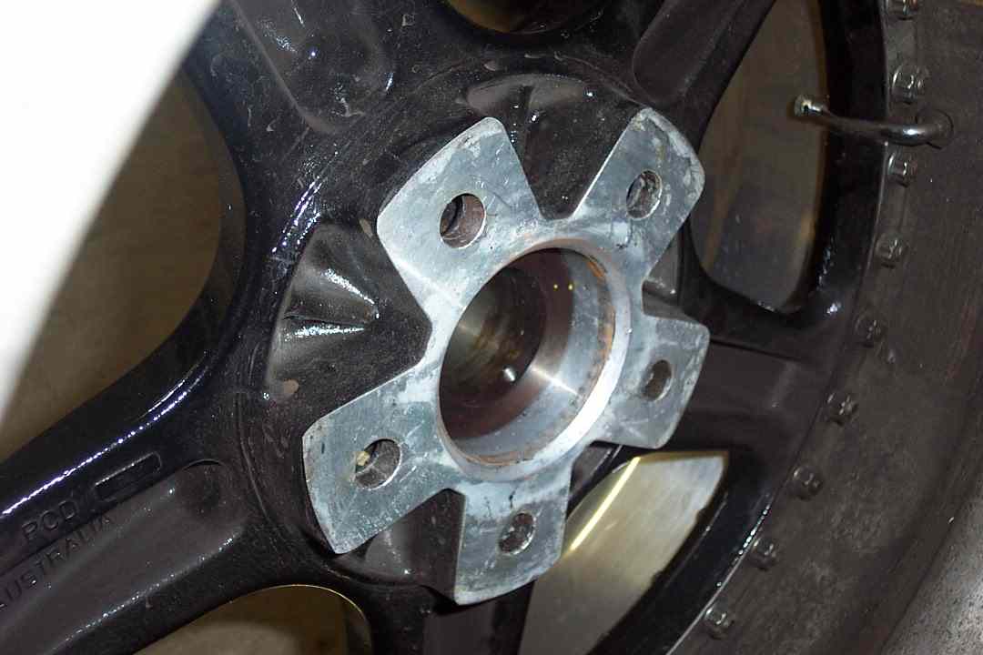

Peter Delaney
As I mentioned, I have Simmons FR17 wheels - they have a generous recess of around 20mm (see pic). In terms of the radial clearance between the calipers & the inner surfaces of the rims, I have about 20mm - Bill Bayard has FR16's with similar brakes & all is ok.
Kind Regards,
Peter D.
