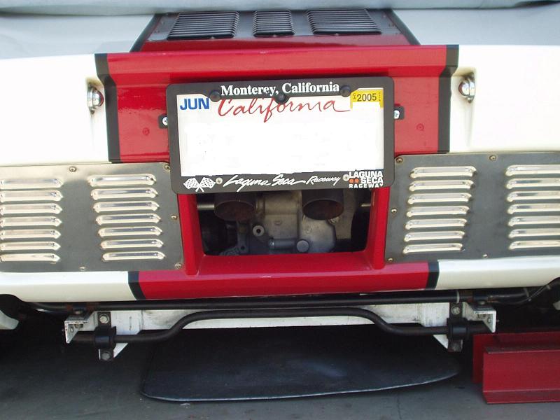

You mean like this (find the camera, not too hard)

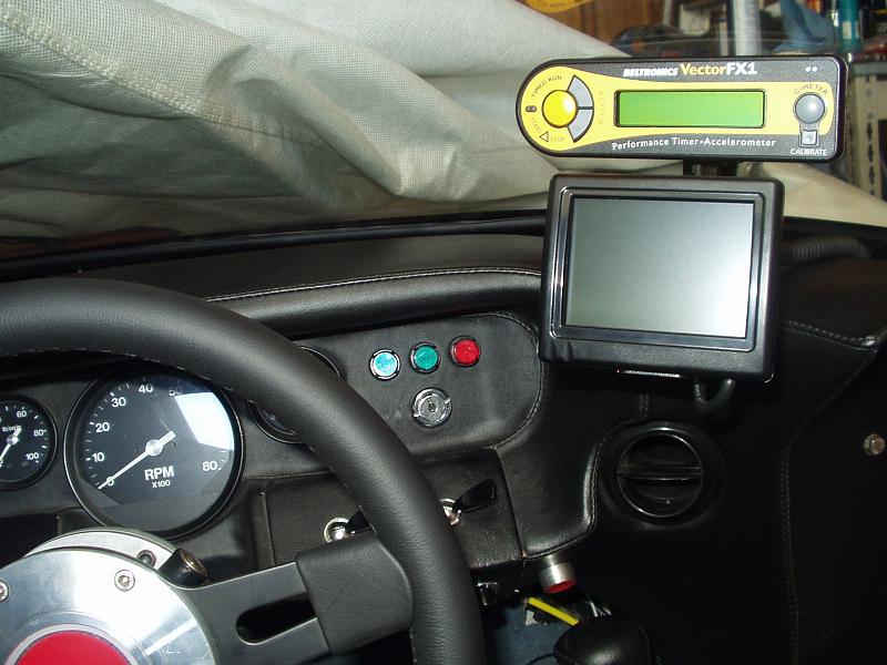

And the Monitor, (3.5", reversable), mounted on suction cup to windsheild. This setup was accomplished without drilling or cutting anything. Field of view being critical, this camera has 90d both vertically and horizontally. I tried a few and found too much and objects enter too quickly, too little and blind spots develop.

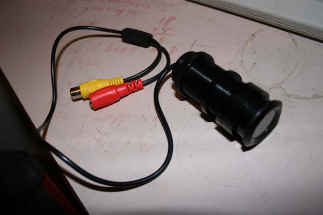

Hi Tim, Maybe this will help i picked up a camera from Jcar Australia when i was over there,it is already reversed 92 deg measures 56mm long x 24mm dia can be hooked up to most av inputs on the incar dvd players, part number was qc3452 comes in pal NTSC etc about $140 aust, not sure if you have Jcar over your way worth a try. Regards GraemeS
