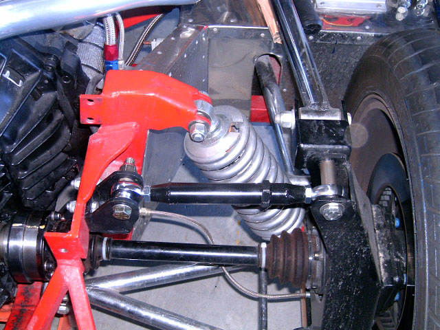

I have wanted to try and do a mod to the rear of my GTD for some time based on the information on D Bell's website.
The basic problem at the rear of my GTD, and it seams D Bell's also, is that as the rear goes from normal ride height to full compresson (bump) the camber goes from the static setting, -1 degree, to about -7.5 degrees @ about 3 inches of bump travel. As messured at the outside of the tread.
Thats clearly too much camber change. It seams to cause the car to go from good grip at the rear on corner entry to snap oversteer as the chassis loads. If you add power on exit it just makes everything worse. Then as you catch the oversteer and the car resettles it goes back to decent grip again. The problem is that the grip limmit is very hard to predict.

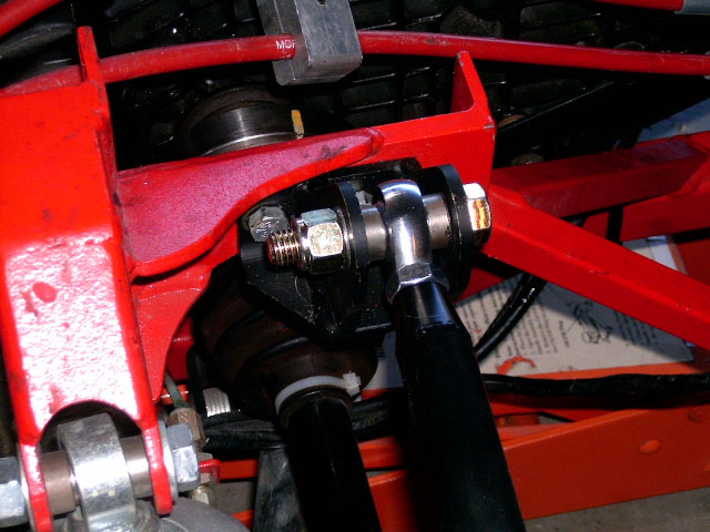

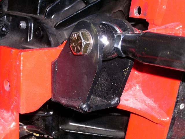

Sooooo... I fooled around with moving the the chassis side upper pick up points. The D Bell site says to raise them to a point that would be in line with the webbing that braces the shock mount.
I did not want to cut into the chassis or weld on it so I made the mounts that you see it the pictures. They mount to the orginal brackets mounting holes so it is a straight bolt on. I also made some adjustable links so as to make camber adjustment easy.
The camber change now with 3 inchs of bump from static is an additional -3.5 degrees of camber for a total of -4.5 drgrees @ full bump.
How does it work? The car seams a lot more progressive now and it can really be steared with power now. I am not sure there is a lot more total grip now because I have no real way to messure it and I have no lap times to compair to but the car is not as scarry to drive and a lot more fun now.
My question to the engineers is about the bracket design. What do you think. Its made of 5/16" thick plate and a 2 X 2 X 1/4" angle. All mild steel. I think it is stronger than the orginal simple "U" brackets. They were mild steel also and 1/8" thick.

Howard, I also did some work on the same wavelength as yourself, only my solution involved modifying the lower A arm instead of the upper arm, but the principal is the same. My only concern with your solution is the loading on the bracket bolts, which now have an additional side loading. Would it not be better, now that you have proved the benefit of your idea, to weld the bracket to the chassis, as you no longer require the bracket to be shimmable to adjust the length of the upper arm. I spent a lot of time on the drawing board with acres of graph paper plotting camber changes at different pivot points ( a CAD programme would have been much easier, and I have Autocad - I just cannot understand how to use it !! ) The solution is in both the position of the pivot point and the relative angles of the two arms. The GTD really does benefit from these modifications - well done. Frank

""My question to the engineers is about the bracket design. What do you think. Its made of 5/16" thick plate and a 2 X 2 X 1/4" angle. All mild steel. I think it is stronger than the original simple "U" brackets. They were mild steel also and 1/8" thick.""
Your design looks good and I don't disagree with leaving it bolt on. You could find a skid pad or cone slalom and do some timed tests and try different camber gain settings. Eventually you might want to weld it but it's probably not necessary.
One thing that is maybe not optimum is your thickness. A bracket like this should be about 1/8" (.125") thick. A typical bracket with this amount of load on one of the original cars or a Mark V would be about 1/16" thick. Granted that's with a welded on doubler washer at the hole and flanged edges which are real labor intensive, but you get the idea.
You are getting some bending loads where the bracket bolts to the frame but I still think 1/8" would work. At this point though it looks like it sort of matches some of the rest of the frame and in order to save a meaningful amount of weight you would have to re-do all the too thick brackets, it's probably not worth it.
On another note I believe angle iron is usually weaker than most tubing, plate, bar etc.
What your looking for is 1018 or 1020,
Angle iron is usually 1010 or 1015 which is ok in this thickness for your application but you wouldn't want to use it in 1/8" in this situation.

Thank you Kalun, The idea was to try and figure out what would work and then have a proper piece made out of proper material and welded up by a pro. Do you think it might be better to "box" the open base area of the flats where they join the angle piece.
I wasn't interested in saving weight. I wanted to make sure it wouldn't break. I am still a little worried about that. I took them both off once already to carefully inspect the welds. All ok for now. The top link sees a lot less loading than the bottom A arms does but home made suspension parts worry me.
Great work Howard, You've done a really nice job. I've been thinking for a while about doing something similar (someday!). How much did you raise the pickup point? About 50mm ??

The mounting point is raised by 1.5" in the pictures using these brackets. They also shorten the lenght of the link by about 1/4"
Great Howard! I like what you have done.Fixed an issue without seriously hacking and chopping the chassis. By any chance did you measure any change in toe-in or caster behavior while making these improvements?

I just reset camber and drove it. I did do a straight line check front to back before and after and I couldn't see any change in rear alinement. I will redo a complete alinement when I finish the front end this winter. I do not think that this mod will alter either caster or toe.
"" have a proper piece made out of proper material and welded up by a pro.""
Lot's of "pros" don't know the diff between angle iron and tubing, shop carefully.
"Do you think it might be better to "box" the open base area of the flats where they join the angle piece. "
If you made it out of 1/8" you could although it's probably not necessary. The pivot through bolt clamping the heim and spacers strengthens the piece in the load direction you would box it for.
""I wasn't interested in saving weight.""
weight savings is free horsepower.
Take a closer look at the next racecar you see maybe specifically a dirt or pavement oval car. You'll see 1/8" thick brackets everywhere.

I raised the top rear link (inboard) by 20mm & this made quite a difference to camber change. However, I haven't used the car under race/heavy cornering conditions so can't be certain this is the best set-up.
