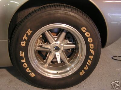

Has anyone looked into these tires or purchased any? Not sure if they qualify as road legal, the compound looks fairly hard in most cases. Another good looking and decent traction tire from GY is the Eagle GT II, again, anyone using these?

They are great for the track or display, but you would probably be disappointed in them for street use.

The blue streaks are not DOT legal. They are a track tire, hook and look fantastic, but will not last on the street for more than a few k mls. They also hunt grooves in the road very badly.
The GY Eagle is one the few tires (besides BFG Radial and Yokohama Avid) that available in decent sizes in 15". Lots of Cobra owners have them and they are ok. Better than the BFG, worse than the Yokos. Traction is very limited even with a 295. However, they will last 30-40k mls pretty easily. You can do burnouts without even leaving a black rubber line...

Thanks guys, that's pretty much what I figured AND they are about $250 a tire so, no thanks. You're right about the availablity of tire sizes for the 15's. The Eagle II's have a decent look to them and seem to have a good deal of sizes to choose from-
At the Tire Rack - www.tirerack.com/tires/tires.jsp?tireMake=Goodyear&tireModel=Eagle+GT+II
225/70SR15 Raised White Letters - Price Each: $71
235/60SR15 Raised White Letters - Price Each: $74
235/70SR15 Raised White Letters - Price Each: $72
255/60SR15 Raised White Letters - Price Each: $79
255/70SR15 Raised White Letters - Price Each: $79
275/60SR15 Raised White Letters - Price Each: $81
295/50SR15 Raised White Letters - Price Each: $99
