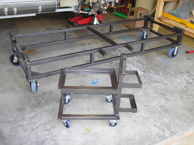

Funny timing on this one. I just finished a dolly to put my chassis on today. I have been building it on jack stands. Now I want to move it around but not have the wheels on it and be so low , so I built this stand . It raises the car up 16 inches , floorpan from the floor . The wheels are rated at 600lb each and I used 1 1/4 tubing 14 gauge wall. I think thats a little on the thin side , but it seems to be ok. They had 11 ga. but all I have to cut it with is a small table saw with 7 inch cutting wheels. The caster wheels cost me 70 bucks, 60 worth of steel , 10 for rustoleum hammered paint (neat stuff ) and I then built a cart for my welder with what I had left over. It took me a day and a half to build it and paint.I also used heater hose, slashed along the length to make cushioned contact points. I used 6 inch wheels on the dolly. Take care, Dan

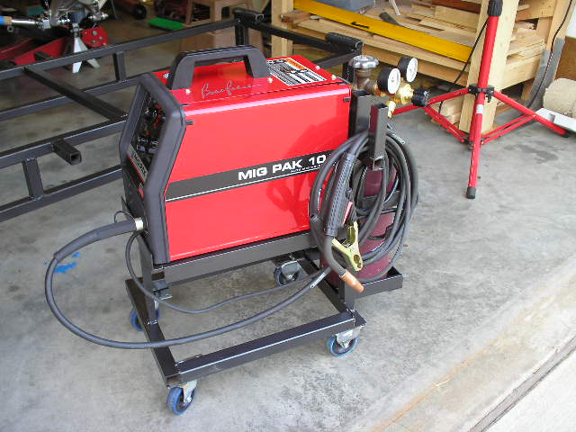

welder on cart

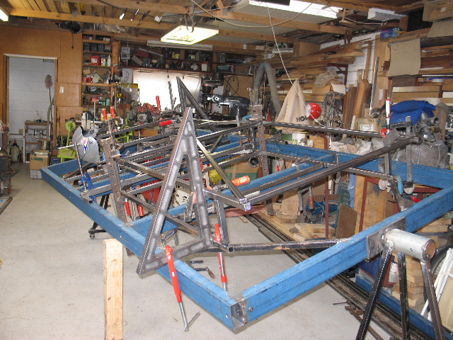

There are some recently posted pics that show my rotisserie stand on my "Kiwi scratchbuilt" build thread. http://www.gt40s.com/ubbthreads/show...0/page/0#60898
It certainly makes working on everything much easier. The pivot was just made up from bits of pipe that were lying around that we machined to a nice slip fit inside each other. The legs and casters also utilised bits that we already had. The bed was made from 4"x2" that I purchased new and we milled the ends so everything was dead square before we welded it up. All lengths for the bed were accurately milled to +or- 0.2mm (or for the non metricated about .008"). The diagonals on the bed are within 0.5mm (or .020"). this makes it very easy for lining things up and getting them dead square when building a chassis.
Hope this is of some help.

Here's a pic that shows a bit more of the pivot and stand. Pretty basic really. A wider base to the stand would have been better for stability but we were using what we had at the time. Also a pivot point ABOVE the height of the bed nearer the CoG height would be better.

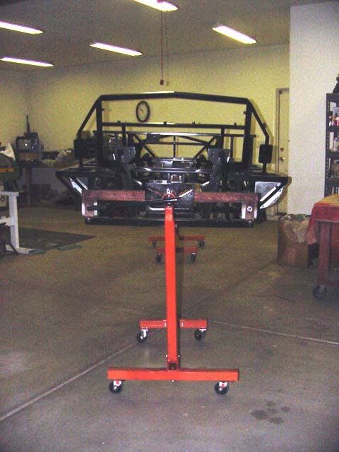

When I built my RF 4yrs ago I made my own rotisouri from cheap engine stands purchased at Harbor Frieght. They were less than $50 on sale. I also bought an eight foot lengh of 2"X4" tubing. I cut off engine stand at the base then welded on a taller piece. I slid the cut off piece into this new piece and drilled holes through both pieces so I could adjust the height. It took about a day and a half chasing the parts and building. It was really worth it too. Kept me from feeling like I was eighty... [img]/ubbthreads/images/graemlins/wink.gif[/img] [img]/ubbthreads/images/graemlins/grin.gif[/img]
Hersh

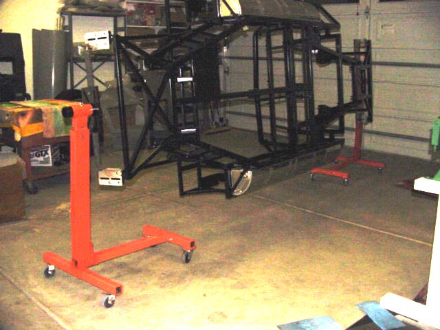

Re: Build Stand
another
