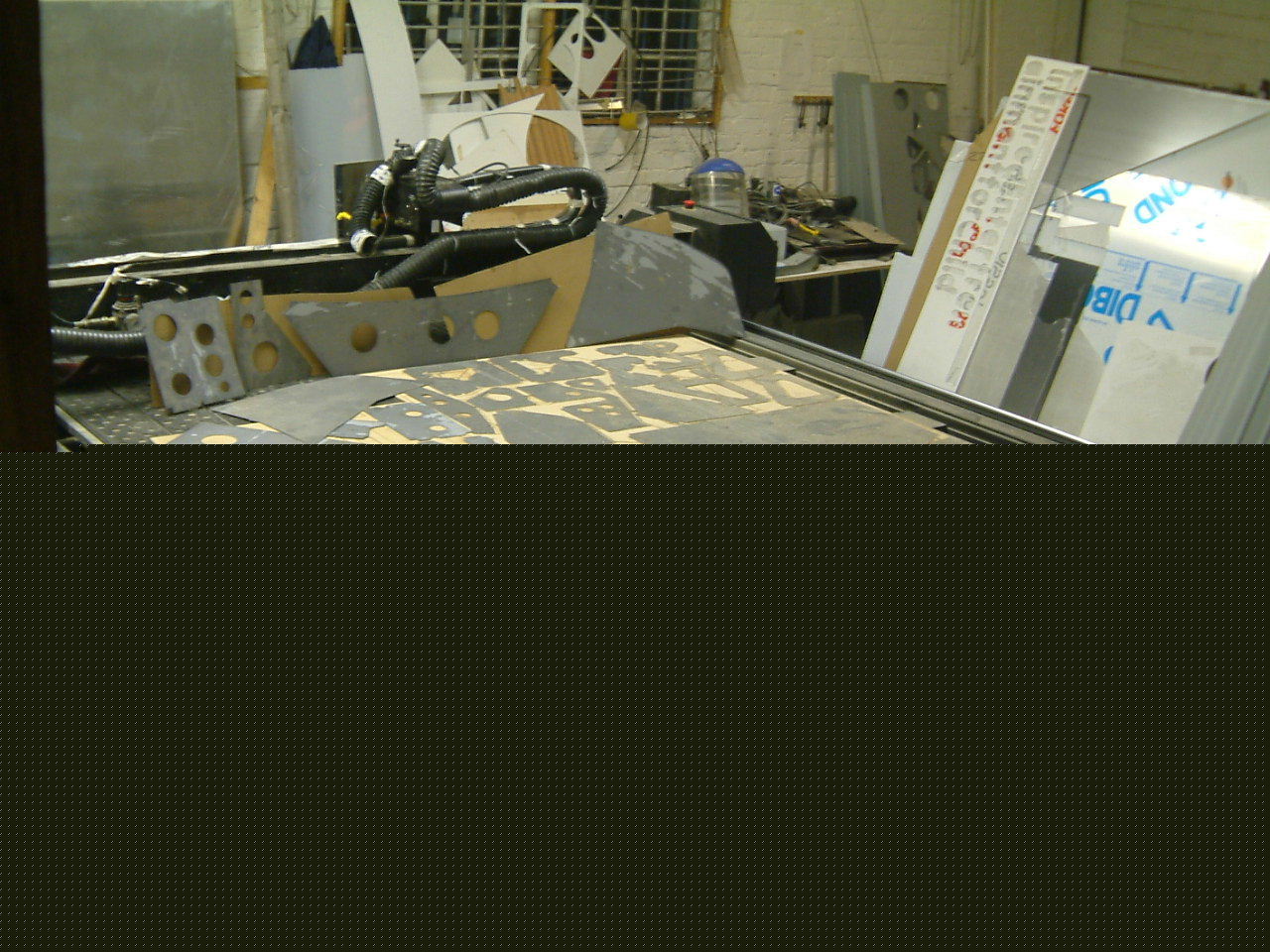

The steel you are talking about from which Goran and I made the first monocoque tub is zintec. I purchased it in the U.K and machined the panel sets here at my premises on one of my CNC machines. The panels were then shipped to sweden where we assembled the 'Prototype'I will post pictures of the machined parts for you guys to see.

Here is a picture of some of the flat panels after machining. I have left cut Zintec steel sheet outside for over a year and the ingress of corrosion on the edges is negligable. The material can be dipped after machining to protect against corrosion until the final surface (colour) is applied. It is true you do need to be very careful when machining to ensure accuracy of the finished panels but this is not difficult to achieve. .
