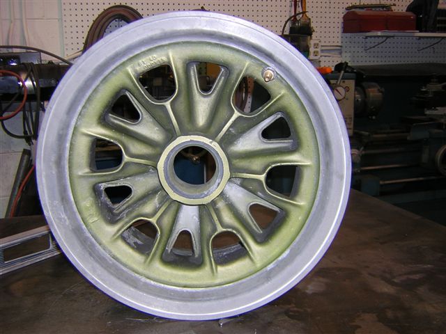

I have been looking at using the Halibrand wheel on my GT40.
Their does seem to be variations between manufacturers & all claiming they are GT40 wheels.
I think some are Cobra wheels rebadjed.
Does anyone have pics of what I should be looking for.

Re: halibrands
Original GT40 Halibrand

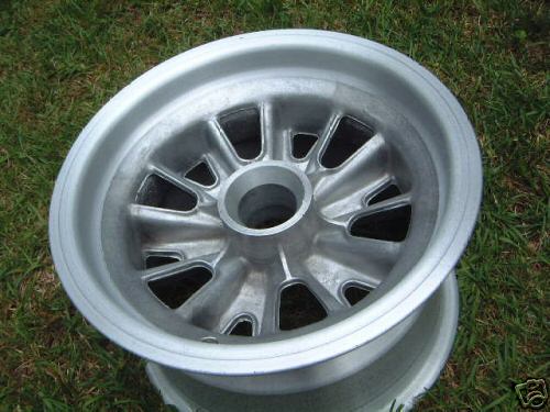

Re: halibrands
Another

Jim,
Your right, there is a Halibrand that was designed for Cobra's and is similar and to the untrained eye it may not be distinguishable. But once you see the difference you will always notice.
As best I can describe the difference, the Cobra design has a "flat" web whereas the GT40 is "rounded" with a slightly different shape opening. Hope this helps.

Re: halibrands
Yep, look for the "wine glasses". Original style have six wine glasses, some replica halibrands have only five.
