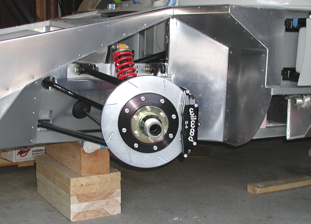

There are number of guys here in US that have upgraded to Wilwood. Below are Trevor Jones's GTD front brake calipers (I hope he does not mind). He has 15" wheels with 12.72" rotors, rally design hats and 4 piston Superlight IIA Wilwoods (note the spacer in front of the hat and "L" bracket for the attachment of the caliper).
Howard Jones (no relation to Trevor) also has a Wilwood set up. If you do the work, you don't need to spend $3000 for brakes, unless you MUST have "gold plated" AP stuff [img]/ubbthreads/images/graemlins/wink.gif[/img]

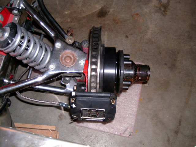

Second

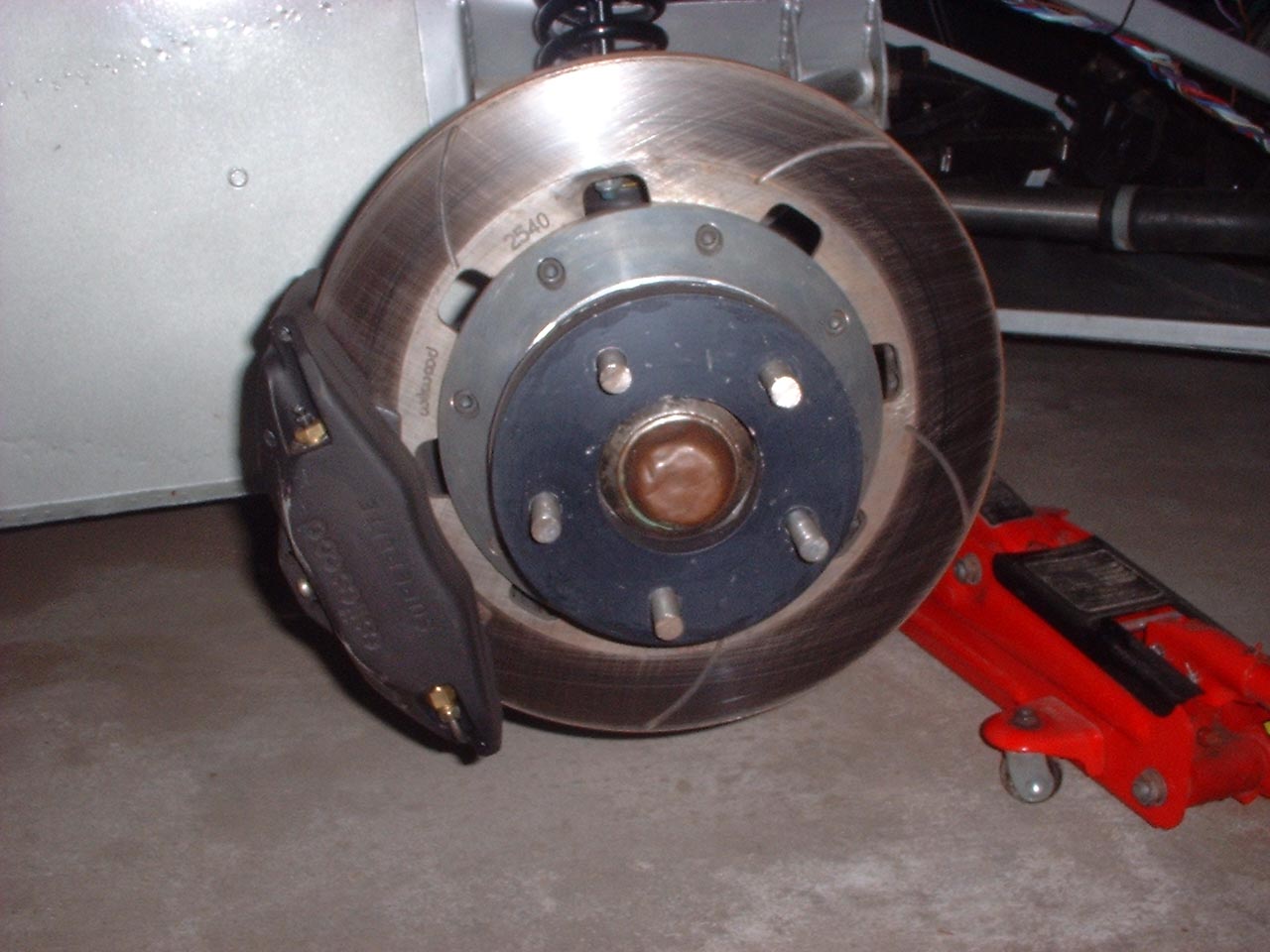

I have AP 4 pots on the front of mine with 315 discs. I picked them up from a forum member here and then had to get my bells made up. Total costs was (at current exchange) less than €1500. I've attachedf a pic. If you are not worried about size on the rear, you could use a Scorpio Granada disc that is 280 and vented and then go for something like the new Wilwood Powerlite rear caliper, you would just have to get the bracketry made up.
Brett
[edit] PS I nearly forgot to add. Are you a member of the GT40 Enthusiasts Club? If so, one of our members had some Ap calipers for sale at a very good price. Might be a start?

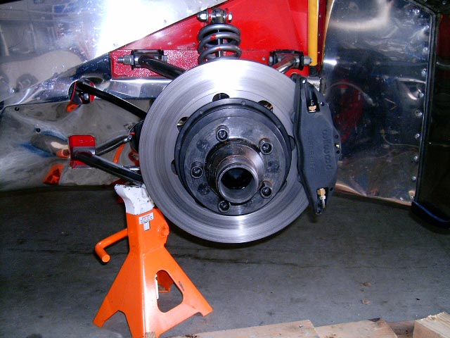

Or you could do this............

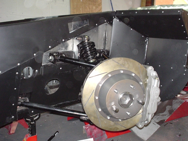

Mine. This was prior to trimming the A Arm

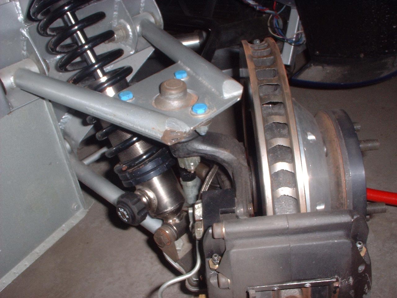

Side view, Superlight 2A with 12.13 diameter HD curved vane caliper.

Sorry forgot the picture.
