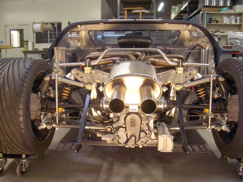

I hope it is ok for me to add some questions to your thread.
I will be getting to alignment on my car within the month and I am really enjoying this and other threads that are now dealing with alignment and bumpsteer issues. Gary's reference article about understand and setting bumpsteer is clear and to the point.
The more I read the more I have realized that measuring and readjusting bumpsteer is a exercise that requires good technique and repeatability. Controlling and/or keeping independent variables from changing while at the same time allowing only the dependent variable to change is really a highly detailed job, especially since 0.050 of an inch is the whole ballgame.
I have been looking for methods that eliminate some of the pitfalls. For example, raising and lowering the car off the ground, making baseline measurements, removing suspension components, and then raising and lowering the uprights to the baseline position all add error to the before and after measurement process.
An analogy would the difference in the precision of measuring a one foot distance with a one foot ruler in one step or measuring the same distance with a 1 inch ruler in 12 steps. In all probability the one foot ruler would always produce a more accurate measurement. I think the same is true for bumpsteer procedures. Everytime the measurement instruments are relocated, or go off centerline, more error and complexity are introduced into the process.
Everyone on the forum seems to focus on holding the chassis at a fixed position while raising and lowering the suspension. Raising the car off the ground with the wheels and some suspension parts removed is obviously convenient especially if control arms are being moved around to find the best pick-up points. However raising and lowering the hub also is raising and lowering the point where the measurements are being taken. It is my understanding that toe-in for example, should be measured in a horizontal line through the center of the hub. Having to relocate the position of the forward and rear dial indicator back to level with the hub each time it is moved adds error to the procedure.
Another method is to leave the wheels on the ground and raise and lower the chassis. I recently found an article about this method on the Pantera website. This method keeps the wheels on the ground and the dial indicators never have to be moved or repositioned. See:
http://www.panteraplace.com/page135.htm
This methods seems to be more direct, easier to do in a home shop. Gary, Howard and Ross, et al., do you guys have any pro and con comments on the two methods?
