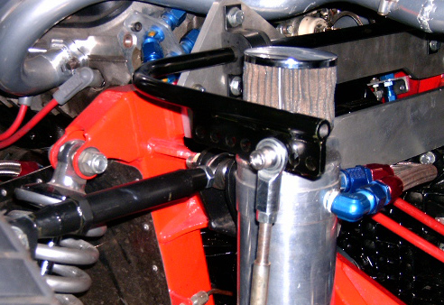

Just to add some shade tree knowledge to the point. I have a GTD with a stock front bar. I wanted to make it adjustable and have the adjustment be in the more effective direction (stiffer). I cut off the flattened tab and about two additional inches from the arms. I then cut a piece of 1" X 1/4" piece of steel drilled 3 holes into it 1" apart, welded them on the end, and located the longest hole (arm length) in the same location minus 1/2" as the original flat tab hole. This has the effect of a reduction in arm length of 1/2", 1.5", and 2.5". It is interesting to note that the center hole seams to be the sweet spot.
I made up some rod end links to replace the rubber things and long bolt.
I also made a adjusable rear bar out of some 5/8 chrome molly with multi hole tabs on it also.

As you can see the front bar has three adjustment points and the stock link has been replaced with my home made one.

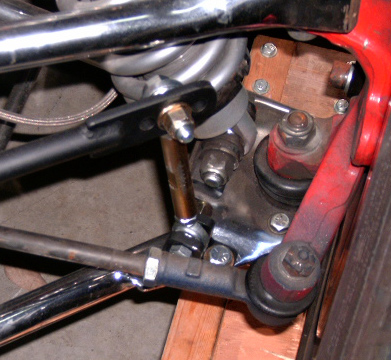

The rear is a completely new bar. Different bend to clear some catch cans but same basic diameter and arm length as original. The main difference is its made from chromoly tubing instead of solid material but with the adjustment set to near stock arm length it is pretty much the same effectiveness.
On this one I was going for a range of effectiveness that spanned the stock setting by about 2.5 inches each way.

Lastly if you study the settings you can see that the rear bar is one hole softer and the front is about one hole stiffer than the stock settings. With the additional overall increase in roll stiffness that was added by taking out all the compliance in the links both front and rear by replacing the rubber with rodends, I am pretty happy with the balance.
Just a little push on entry, neutral on corner center, and lightly power on loose on exit.
