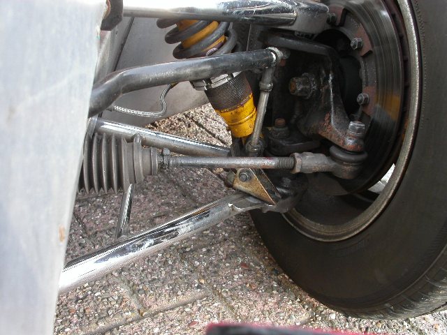

Traying to put in pic the reply.

I think we have a picture

From your picture I can tell you that that is not a "standard" GTD front sway bar. It looks like it might be 3/4" diameter or larger. The "standard" GTD bar is 5/8". Now that is not to say that anything is wrong. In fact the front of the GTD could use a little more front bar effectiveness when run with the standard 200 lb springs and crappy shocks. Sorry yes those Spax's are the ones in the picture I refer to.
It looks to me like you have quite a bit of ride height set in or the springs you are using are shorter that what came with the Spax's.
The main thing about the roll bar is it should not have any effect on spring rate unless the car is loaded side to side as in turning. It should be free, within reason considering that the rubber must compress just a little to locate the bar, to move up and down in its rubber mounts if the links are not connected. Check to see if the original 5/8 diameter rubber bushes were retained for use with the new thicker bar. The inside diameter of the rubber bush should not smaller that the diameter of the bar.
The comment above about pre load is correct. Attach one side (links) and then adjust the length of the other link so that it can be attached without deflecting the bar at all. This is done on level ground with the car sitting fully on it tires.
The actual orientation of the bar doesnt make any difference other than any possible interference with other suspension components throughout the suspension movement up and down. There should be none. I should tell you that the "standard" GTD sway bar links are designed to limmit turning radius. Contact with the steering links at full lock is normal.
As far as the tire squealing goes, mine does also. I have very little caster in the car and I think this is part of the the problem. Replacement adjustable front A arms are in the works for my car this winter.

Howard look the picture and see how i put the under u-ball of the vertical rod of the swaybar in attacht with an u-shaped peache of metal inwards on under wishbone.
I have full turns of the stearingrack now.
