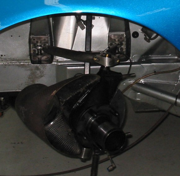

I had the opportunity to look closely at the front suspension of a V8 Supercar (local touring car) and noticed something very interesting. All rose-joints were mounted horizontally (with mounting-bolts vertical rather than horizontal). The V8 Supercars here in Australia are the leading category of motorsport and teams have multi-million dollar budgets so you can bet that nothing in this area is done by chance. So I began to wonder and it became obvious to me that htere are some real advantages. All large forces applied to the rose-joints are either in the plane of travel or along the plane of the wishbone. So with a conventionally mounted rose-joint, under braking the spherical bearing will be trying to pop out of its housing. However, with the horizontally mounted rose-joints, the spherical bearing will always be pushing into the socket of the housing in all circumstances. Consequently, the forces within the rose-joint will be applied over a larger surface rather than a thin shoulder… much more reliability and less prone to wear. A still further advantage is to the rose-joint mounting brackets on the chassis. The forces will be applied along the plane of the bracket rather than being perpendicular to the plane, so reducing the bracket’s urge to bend. Anyway, thats how I see it.
This is a long way to ask the question but given these apparent design advantages, why is it that so many cars are designed with rose-joints placed vertically? And is it enough of an advantage to consider a modification to horizontal mounts?

If a rose joint is what you call vertical it will have the advantage of a vertically transmitted load going into the casing of the rose joint. If horizontal as per your picture only the rose retaining clip or whatever will resist the load and may fail under duress. I would not be keen to see some of my suspension joints with horizontal rose joints for this reason. IMHO of course!!!!
Horizontal, vertical, diagonal... since it is a spherical bearing, why does the position affect the forces and wear in the rod end (rose joint)?
One advantage to the horizontal mounting shown is quick suspension geometry adjustment (roll center, anti-dive, etc...) Another is the simple fact that if the nut should come loose and fall off (small chance), the bolt has a better chance of staying put until someone has a chance to look the car over (which happens every day in a race environment).

The prime reason for mounting them horizontally as Chris P has said is for suspension tuning. If you look at your photo the joints are held between wide based brackets with long bolts, not ideal from a theoretical viewpoint but makes for easy and relatively quick handling adjustments merely by shimming the joints up or down within the brackets. Being able to adjust these also means you can change your ride height without compromising your suspension settings.
With a softer sprung road driven car you would most likely need more movement in the heim joint than a horizontal setup would offer particularly on the top link. Obviously binding of the heim joint could cause it to snap. With vertical mounting this is not likely to happen.
Actually, upon a second consideration, there is an advantage to horizontal mounting which Chris Liokos has mentioned already. To give a specific example, braking. There are longitudinal loads (in the x direction as set forth by capaci) which will be held better by horizontal mounting. Since on the upper arms in that photo there are no sway bars, springs, or shocks, the suspension arm forces are purely in plane with the suspension arm (depending upon the slight angle of the outer ball joint if there is any, and the design of the ball joint). However, large enough inner rod ends in a vertical position will hold these forces that tend to "pop" the ball out of the socket just fine. These maximum loads are always provided by rod end manufacturers. Look at the outer rod ends on the lower front arms of just about any race car. They are in the "horizontal" position for steering movement and carry vertical loads from springs / dampers / shocks. Also, the bottom arm takes higher compression / tension loads then the top arm due to simple geometry reasons.
One reason for using a vertical position is simply to have enough room for travel. If you have a very short suspension arm and appreciable wheel travel, you might require a vertical orientation unless you use a more expensive high misalignment rod end, if it will even fit.

Here's my 2c's. The main and by far the most damaging loading on the rose joint either way you deside to mount it is going to be as the suspensions "bumps" In this case isn't either method equally effective? Rose joints are not intended to be loaded beyond their maxium defection angle and certainly nothing like 90 degrees to the threaded shaft.
Having designed competition and road suspensions, I fully agree with just about everything written here already.
The main factor for using a horizontal mount joint (vertically pinned), is for adjustability. The upper and lower arm can be moved independently with different bushes to allow for: roll center change, instant center change, anti-dive/anti-squat changes, and changing the relative angles between the arms for different camber curves.
Secondary is to put the joint in its strongest position to deal with braking forces. ( peak decel is usually the highest G load) Most suspensions are designed with enough reserve strength in the joint such that lateral loads are not a true issue, and competition cars generally have very short travel and little body roll to deal with.
For a road car, I would not put the joints in the horizontal position only because of the greater travel and steering angles can put too high a load with included larger angles on the joint.
