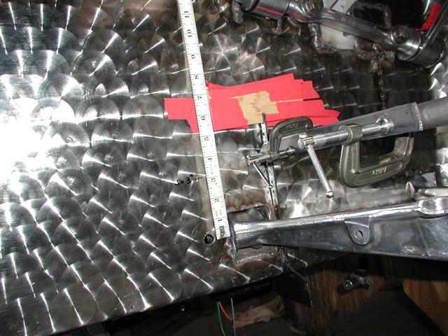

I have gotten my steering rack, a unit from Flaming River. The rack mounts are a little narrower than what comes on the DRBs(15 1/2 vs 17) and moving them is no real problem. The point of the universal joints(don't know its real name) in the rod ends are 24" apart. The mounting bolt for the lower A arms are 24" apart. My question is, will this create or increase bump steer and if it makes it worse, what are my alternatives. I believe I read somewhere that raising the rack will help cancel out the bump steer problem. Where does the line of the shaft have to be in relation to the mounting of the rod ends(C-4 Corvette suspension)? Not being an engineer, I am way out of my knowledge base here. I also don't want to make a bunch of holes in the shiney new stainless getting it mounted. So a little info from the more knowledgable ones would be appreciated.
The best thing to do is to put the rack in and clamp it in position and check the bump steer. Depending on the results you get you can then shim it to raise the rack or move its position forward or back and clamp again and recheck until you get it right.
Regards
Paul,

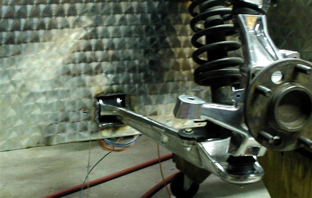

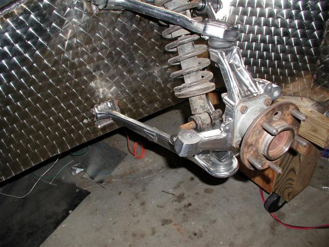

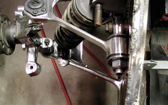

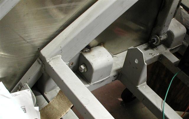

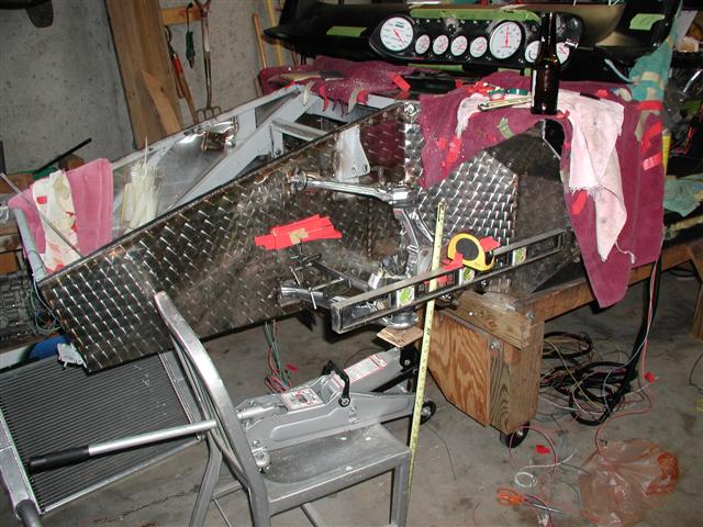

Thanks for the imput. Since I have to move the "stock" mounting position to get the mounting holes to line up horizontally, I wa hoping someone would chime in on the vertical component. I plan on taking the car to a well known Corvette racing shop next week for front end work. They may be able to work out the bump steer. I was hoping I could go in there armed with a little information. The lower A arms have a little room for front and back movement and will have to be shimmed into place just as they do for a factory setup. I was hoping that I could get info on the geometric placement of the rack(3D) in relation to the location of the steering arm. Here are some pics of what I am working with.

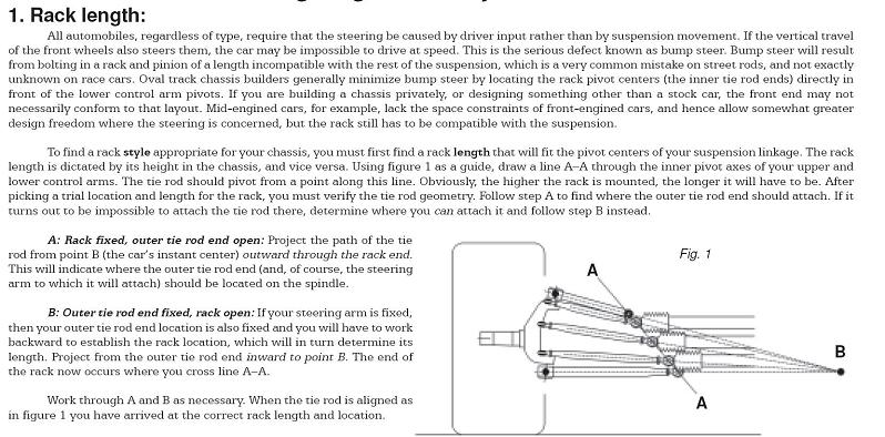

Here is a portion of the rack tech section on Woodwards web sight. It has some good info on getting the correct rack position and length.
Richard

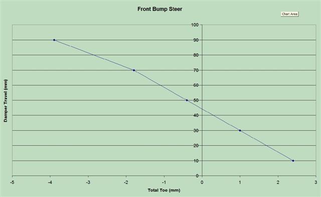

Bill, while Richards article helps it does not allow for the amount the steering ball joint is outboard of KPI ( a line drawn thru the center's of the top & bottom ball joints ). You must double this & add it to the rack measurement for total rack length. If your having trouble following this PM me & I will give you a 'country boy' explanation using Richards drawing feature's as a guide.

I think Richard's article will get me started. I would appreciate any info via PMs etc. as this will be a foray into unknown territory. The alignment may wind up being exactly where it should be. The outboard ball joint is only about 1/2" beyond the lower A arm attachment point on either side. The upper A arm attachment is just outside the cladding. It apears(in my minds' eye) that movement of the rack will be minimal for cancelation of the bump steer. Richard's article will get me started, but do send any info on the setting up of the steering, as that is where I am at present. Thanks guys. I am sure this info will be helpful to a lot of others.

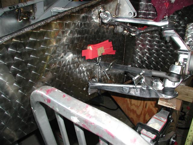

Bill,
Maybe this will help, it's one of the best & most simple ideas I've seen for checking bump-steer.
You can see in the photo I clipped a laser pointer to the hub. you can pick up these in the uk for 3-4 pounds.
All you do is pin a sheet of graph paper to your garage wall where the pointer strikes (the further away, the more accurately you can measure) & you can plot the amount of 'steer' as you raise the suspension on, say,wooden blocks, 1 inch at a time.
you can easily clip the pointer on different parts of the suspension & track & mark the different radii of the various suspension components (as pointed out by Phil).

Clamp the laser to the upright[ with coilover & steering removed] and plot laser arc on wall while lifting suspension thru travel without bumping upright, then refit steering arm, replot arc & compare.

Every method you stated will work with a completed car (some better than others). But, Bill is trying to locate the rack (which is not mounted) to minimize the steer. As you can see in his pictures he has spent a great amount of time on his paneling and it looks to be fastened to the frame with welds. I don't know about you but punching holes in that nice work just to see what the steer would be with the rack in that position does not look like a option. With that said, the only method to determine the best position is to do this on paper (or cad). Or it just looks that way to me.
