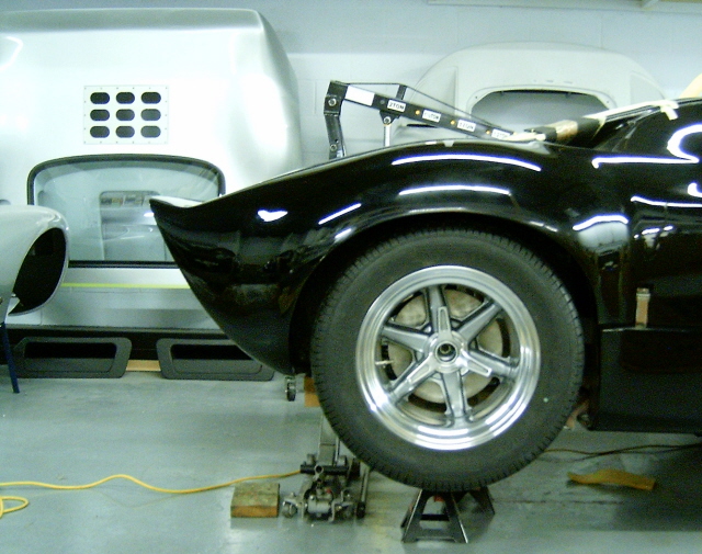

About the Pirelli PZero 345/50/15s. They are smaller yes, but fit well and are seriously wide. Here's a pic of one in our shop. The fronts will be 225/50/15 PZero to keep it all in the family.
The black CAV GT with the 345s has a 347 Ford Racing crate engine, Webers and RBT 6speed. Mathmatical top speed over 230mph at 6000rpm so comfortable highway cruising will be no problem.

The Cav with the 345 pirellis looks a beast. I really wanted to see what the 345's would look like on a GT40 so thank you for that.
I will leave Malcolms thread alone now and let others answer him regarding the Avon tyre sizes.
235's would be my choice also for the fronts.
Last thing if you don't mind,
How does the reduced height of the tyre (Pirelli 345's) affect geometry, steering, anything else I haven't thought of ?
Are there any issues at all with running a tyre with a diameter of 625mm rather than 670mm ? I am refering to the matching front pirelli 225/50's as well.

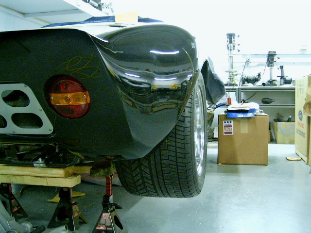

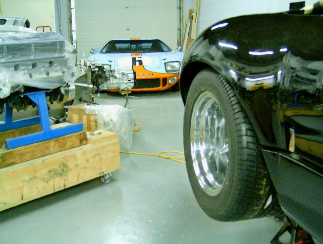

Hi Ron, Martin,
Here's a couple more pics of the 345 PZero on our customer Gulf body CAV GT. We were checking fit with revised lower control arms incorporating new geometry to suit the rubber.
The front suspension will be done shortly, does not change the wheelbase or track, just everything else, it will be a "must have mod" for anyone looking to track a pre 100 CAV. Stay tuned

Us yankees on this side of the pond probably have it more difficult than those on the other side - when I checked with Avon about two months ago to see if they were going to distribute the 295 and the 275 rear tires in the US they said they had no plans to do so and these tires would not be available through any dealer in the US. Bummer. Does anyone know if this has changed?
Sorry in advance for the thread wander above....now, getting to the original question... Many CAVs came stock with a 225/60/15 BF Goodrich TA with no clearance issues, although, it is close as a couple of times there has been just a touch of rubbing on the wheel well. I suspect a 235/55 would probably fit fine - as good as the 225/60 anyway - and provide a little better lateral traction up front. The stock 60 series tire is nice on a bumpy road, but, not a great peforming tire for track work or really spirited driving. So, yes, please, Avon bring it on, and, in the US!
