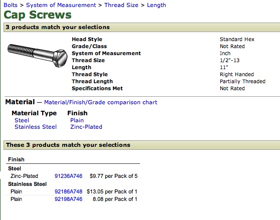

Hi John,
McMaster-Carr. I'm not familiar with how your fasteners are loaded/stressed, but these are probably better than the home depot threaded rod. 92198A746 (18-8) is lists a minimum tensile strength of 70,000psi. The more expensive 316 version should be stronger (tensile strength wise) but this spec is not listed in the data sheet.
Al

Lynn's post reminded me that you can get it in grade 8 from fastenal.com (for $5) :
1/2"-13 x 11" Grade 8 Plain Finish Hex Cap Screw | Fastenal
You may have a Fastenal store close to you. Mine was hidden in an industrial park (just a few minutes away) and until I checked their website, I had no idea it was there.
