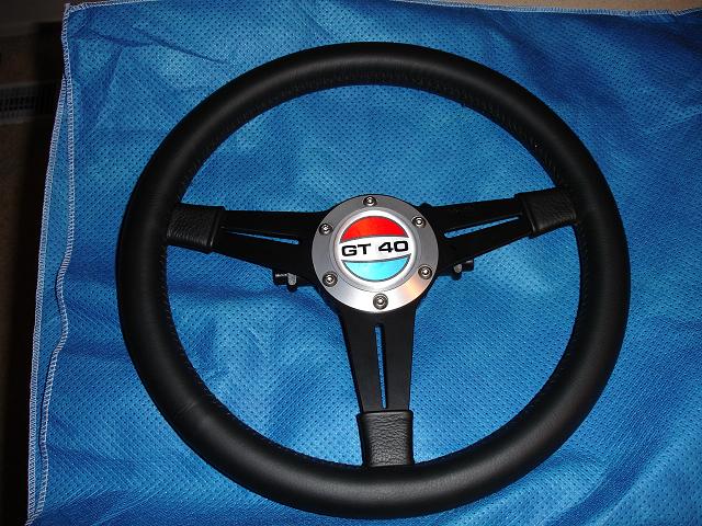

Mark / Peter, See attached pic of finished front of unit, the quick release unit is designed to fit the standard Mota Lita steering wheel, has custom made front and rear adaptors to fit to a SPA quck release steering mechanism, with a splined spigot shaft that is welded onto the end of your existing column, not useing the splines you already have. About $500 not including the badge, or carriage.

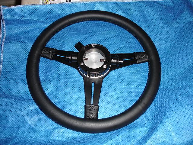

Another pic

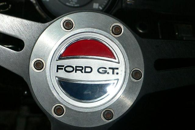

My RF-supplied Moto Lita wheel has 9 bolts rather than the six on yours, Frank. Is this an unusual variant? Peter, does your RF Moto Lita wheel look like mine?
Steering column end has a 5/8" 36-spline.

Mark and frank,
I did not dissasemble the wheel on RF80 but it seems to be the unit Frank shows in his picture with 6 screws. This caused me to look back on my build site for RF90 because I throught it had more screws. As it turns out the wheel on RF90 was like yours Mark with 9 screws.
