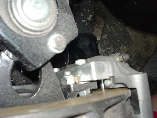

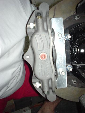

Thanks Ian for the compliment, but I have the Wilwood's on the rear of my car. I have some AP 5000 4 pots on the front.
Dave, I'll try and take some pics today and send them to you.

The are 315/28 and the calipers are these here: Brake Calipers, Air Jacks, Brake Discs, Brake Fluid, Brake Kits, Pads, Clutches, Master Cylinders, Pedal Boxes, Slave Cylinders from AP Racing
Sorry, forgot to taker a pick, as I was busy working on the car today, will open the garge up and send you one ASAP.
Brett

Here you go Dave,
Let me know if you need any more

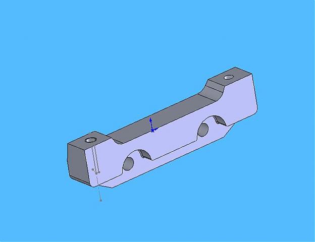

I'm now designed my own brackets which a local engineering co is making for me.
I dont know whether the Cortina lug spacing is the same as the Granada, but if that is the case, raldes never gave me any alternate suggestions when they dropped their idea to design the GT40 / Granada brackets after months of exchanging emails. Despite that it was still advertised last time I looked.
Rant over, but I appreciate the suggestion.
The material is on order, so I will post some pictures once I get the brackets and put it all together.
Dave

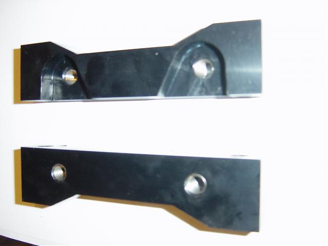

Hey Dave, Look very similar to the rear brackets I ave for my Wilwood handbrake. When I get home later I'll dig out the photos I took.
Brett

yes I think that the Princess caliper is a worthwile upgrade and it does have the same lug pitch I think.
When I looked at the braking system as a whole, I wanted to maintain good front to rear balance and pedal effort because I am not using servos. Now the rear brakes were difficult to fit in the space available, and as a result I needed a 310mm disc to clear the lugs and bolts. I wanted an integral mechanical handbrake, so I chose hispec billet handbrake 4 pots which have 38.6mm pistons. Incidentally, the only off the shelf disc I could get to fit was a Wilwood, hispec could not supply the required diameter / width.
This meant that for good front to rear balance my best choice seemed to be Wilwood 1.75" (44.5mm) 4 pots at the front.
So I hope to get good balance and pedal effort from these choices, and if I do need to tune it I will then change master cylinder bore sizes.
Brett,
I found that the front bracket had to be deeper because the lug radius is smaller 3" compared with 3.5" at the rear. So the standard Wilwood 2" aluminum bar wasnt quite big enough for a one piece bracket, so I ended up getting them made.
Dave
Dave,
Same with me. I didn't buy the Wilwod bars, for a start, you can get the material cheaper if you look around I bought some bigger pieces and Brian Magee machined them for me.
Brett

your brackets are very similar, but being for the front, mine look a bit deeper. Overall demensions are 185mmx52mmx37mm, I checked with a local supplier for material 2040-T315 and found prices of £60 for one peice so it isnt cheap. Together with machining and stainless spacers between radial mount and caliper, its loadsamoney.
Cost aside, the brakes are the most important part on the car, so I havent compromised here. But to reduce the impact on the wallet of the total front and rear brake system cost, I took my Impreza off the road, and am currently saving £100 month in fuel -thats dedication to the GT40 for you .
Dave
