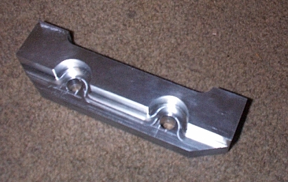

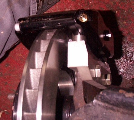

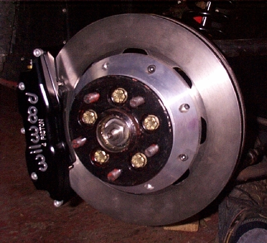

Here are pictures from my first fit.
Yuji, like Simon, I was really pleased with my Hispec (rear) brakes too, at the time they didnt offer a kit so I specified the bracket dimensions and they adapted their existing bracket design for me.
The Wilwood front discs are 310mm dia x 32mm. They fit fine 10mm+ clearance inside my 15" 3 piece wheels.
The only small difficulty I had was fouling of the caliper bracket on the bottom suspension arm at full droop full lock, cured by grinding a notch in the end of the bracket. If I was to do it over, I would skew the bracket to lift the caliper 30mm or so.
Dave

Yuji,
With spun or fabricated rims for 3 piece wheels, the wall thickness is only about 2.5mm so the internal radius is larger than for a cast wheel. This allows a maximum disc size of 310mm, which leaves about 6mm radial clearance between the Wilwood caliper to wheel inner surface. My 15" 3 piece wheel has an internal diameter of 365mm.
You have to be sure of your own dimensions or it will be safer to stay with a 295 or 300 diameter.

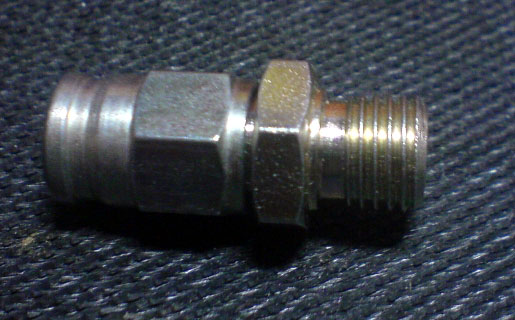

Guys, a technical question on NPT taper fittings as for Wilwood Superlite
background:- I ordered Euroquip -3 brake pipes from Rally Design with 600 series fittings RD1538 for the Superlite Caliper. On their web site the item picture shows what is clearly a taper fitting. However, what I received is different, clearly a parallel fitting designed for a copper ring seal. It does enter the caliper, has 27tpi, so I presume that it is NPT parallel. When I phoned, their response was that they had supplied correctly, and were in denial when I pointed out that it was not a taper fitting as displayed on their web site. I can send them back of course, but they do not have an alternative, which leads to my question;
question:- Is it ok to use a male NPT parallel thread with a female NPT taper thread on a Wilwood caliper?
regards
This time with a link to the item on the site
Professional Motorsport Parts, Spares & Rally Equipment from Rally Design
and below, a picture of the fitting received.
regards

I have the Powerlite Handbrake calipers and they use a tapered 27TPI thread on it. I'll double check tomorrow for you, once I recovered from going out tonight.
Brett
