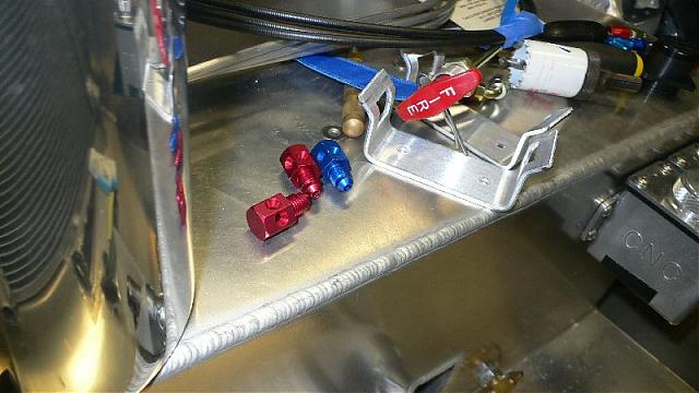

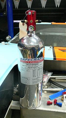

Here is a couple of shots at the stuff that came in the box. I got the RS 10lb unit.
Sandy

Thanks, I didn't think of that spot. I was looking more in the foot well area. But the I think the tank and head assembly is too long for the area in front of the seat as it's not very wide. The 10lb tank is long with the head but I would rather sacrafice passenger comfort then going to a 5lb system. The GT40 does not have loads of room for the gadgets that's for sure.

Thanks Neal, I think yours is the LT version of the tank and I have the RS version which uses a different head and tank. Will just have to see if it fits, might just make it, or might be worth looking at that style of tank and head in 10lbs size. As that really tucks in nicely.
