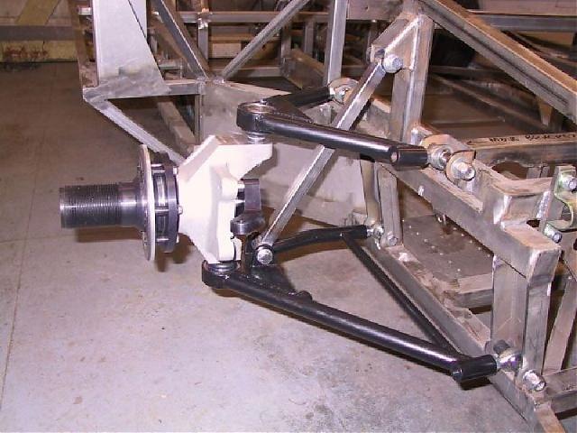

Bruce - when I've needed to move a racecar chassis around (roller) and have yet to select shocks and springs, I just weld a short piece of flat steel to both ends of a length of 1" tubing, drill holes in the steel to put the shock bolts through. Viola! It's now able to roll on it's own wheels.
If you spend the time to engineer these pieces to the correct ride height for the car, you can also use them for setup purposes such as alignment..

like this

Yep - that's it Frank..
