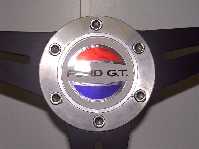

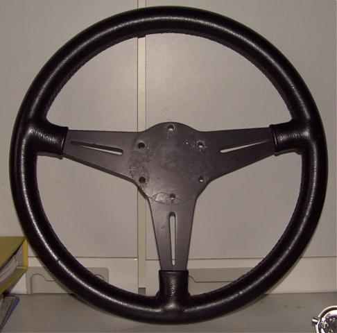

Scott,
You need the Moto-Lita 14" GT40 wheel, available in black or dark blue. (01264 772811)
The price is £117.00+VAT and delivery is about 3 weeks, as the metal blanks have to be sent away for hard anodising before the leather can be sewn on.
The mounting pattern is 6-bolt, which will hopefully fit your Sparco adapter. A correct mounting boss is available from Frank Catt for £40.
Tony Hunt

Scott,
Have one too as Tony mentionned.
The orginal was 14' but I took a 13' as it a big one.
I also took the dark blue as said being the original color on P1075.
Recommend Moto Litta as great stuff but a bit expensive.
Success
fred
