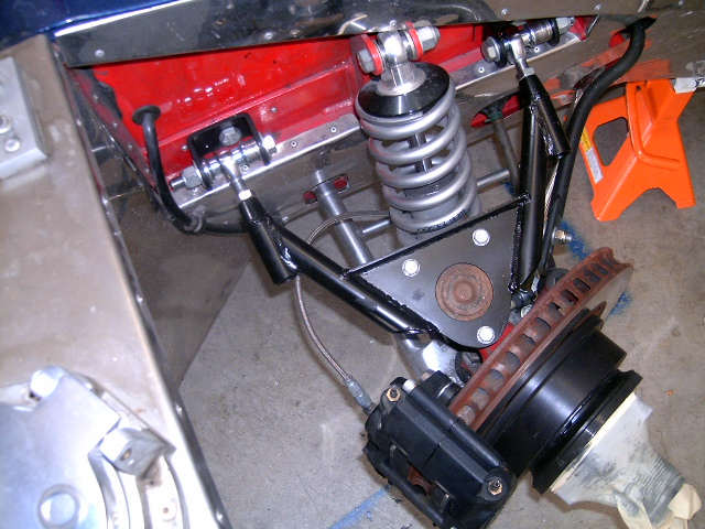

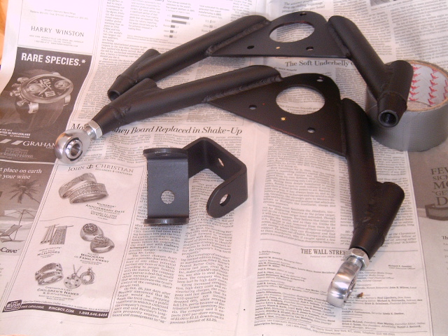

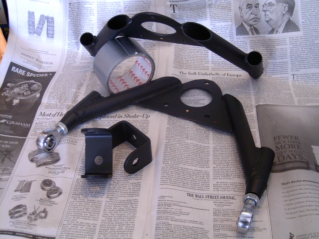

Here's what I've been doing the last couple of weeks.

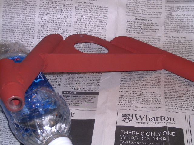

The problem we have with the front of the GTD chassis is nothing is adjustable, really. You can shim some things and move the others around in slots but neither really solves the problems. I began my GTD suspension journey at the rear with trying to address the huge camber change under bump problem and I believe I have made at least my car a lot better at the rear. This has caused me to really begin to feel the lack of camber for one and nearly no caster for the other at the front of my car. I have removed all the shims in an effort to increase camber somewhat and found that with all I can do the RF is .25 degree neg and the LF is about a 1/8th of a degree POSITIVE! To make matters worse the most caster I can get on either side is about a degree and a half neg.
All of this pointed to new upper A-Arms and mounting points. As you can see the camber is adjustable. I made them 1/2" shorter and with the 1/4" I gain with the mounts, this should give me about a max camber of -3 degrees with the rod ends all the way into the bung . The mounts are offset to the rear and with the increased adjust-ability by spacing the rod end in the mounts, I believe I should be able to set the caster to a range of -1 to about -6 degrees.
I have also eliminated the slots. I have been having problems with the settings changing due to curbing the car at the track. The slots just don't work and I believe I will have solved that problem by drilling fixed mounting holes in the U-shaped mounts instead of slots.

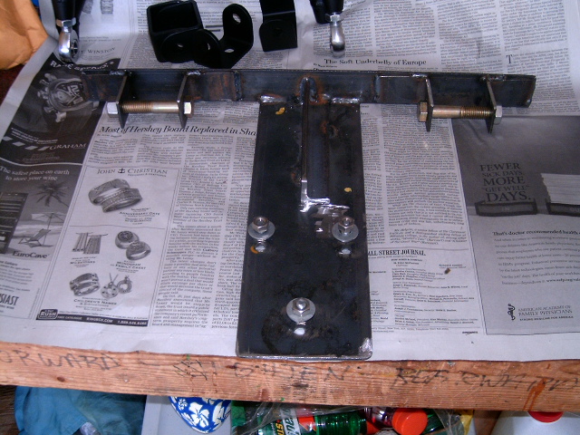

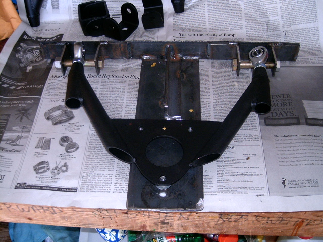

The bottom picture is the jig I had to make off of the original GTD A-Arm. What I did was copy the original part and move the 3 holes the upper ball joints bolts to inboard 1/2".
I should add that the material is 4130, was preheated before welding with the proper filler rod and then normalized as a complete assembly. I got the bungs from The Chassis Shop, the flat stock and tubing (.085 X 1) from Aircraft Spruce, and the rod ends from Jeg,s.
I did all the fitting and had a very good friend at work do the welding. It's amazing what you can do with a hacksaw and a 1/2 round file and a 3/8 drill motor. But then you gotta be "The cheap Italian" !!! to do it like this.

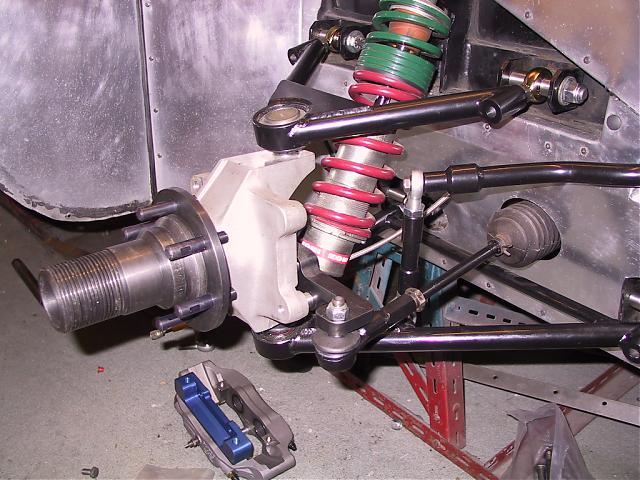

Hi Howard, nice work with limited tooling, well done. Have you considered putting a web along the back of the outer plate ( near the three holes ) to prevent any stress on the linear weld between the plate and the tubes ? The plate is quite wide, and any twisting action in movement may stress that weld, how ever good it is. Better still is to consider a spherical bearing on the outer end and bring the arms together more, then you can dump the old cortina swivels. Just a thought ( as you say " my two cents worth " ) Frank

Damm! I agree with Frank again and think that the flat plate could bend/fail under load. Bottom arm takes much more pounding than top arm but still I would hate to hear of an issue after installation. Surprised to hear you had so little adjustment range initially but this should really transform things for you on set up. Good stuff. Let us know if it improves the driving too!

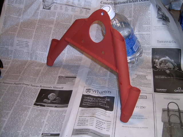

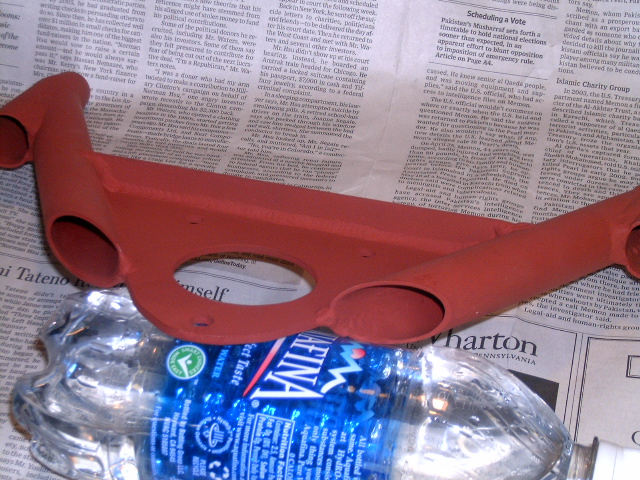

OK, Here's the fix. I used 4130 1/8 X 1" strip I got from Aircraft Spruce. They are still in the primer here thus the ugly brown. I still need to turn down some spacers before I can put them on the car. I will post some more pictures after I get them installed.
Again thanks guys!

Thats got to help a lot! I have successfully mixed GTD and Southern GT arms and uprights etc together to good effect. Contact Mick and see what he can do for you.

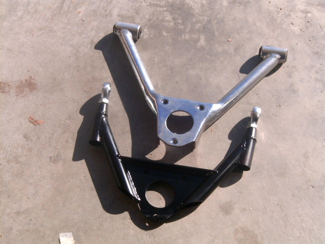

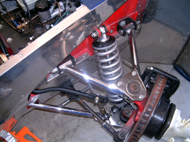

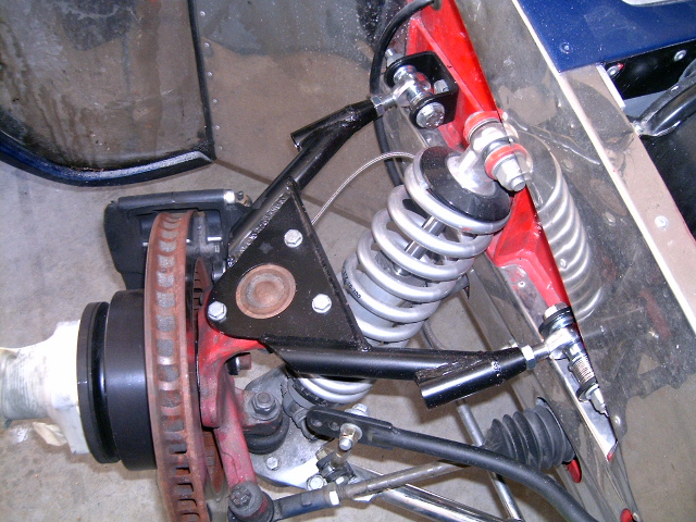

So here's how it worked out. The first picture is of the original GTD A arm. Then the next few are of the new ones installed. Lastly the two of them side by side.
I was able to get as much as -4 degrees of camber right off the go. Set afterwards to about -1. I intend to set the front to about -.5 at the alignment shop. Also as you can see I can get at least 3/4" more caster. I will need to set this at the alignment shop but I would like to see what about 3.5 degrees of caster feels like. Toe for now is as straight ahead as I can do with a steel tape. I would like to set this at 1/8" total toe in at the alignment shop.
I don't like how far the rodends are out of the bungs so when I do this the next time I am going to put 1/4" shims behind the mounts. This ought to put the treads far enough into the bugs to be safe.
So all that's left is to work on bump steer. Maybe after the first of the year.

Hi Howard,
I was just reading about your plan to shim out the mounting points for the arms. This would seem to be a very bad idea as you will move the inner pivot out of the plane of the supension pivots and track rod ends. Unless you are very careful about rack position you could end up with horrendous bump steer. On my car this was done and the bump steer was very bad. A much better solution to the issue of the threaded portion of the heim joint being too far out of the threaded tube is to make the tube longer. A pain in the ass I know as it invoves yet more cutting and welding but ultimately better than incurable bump steer.
Howard Jones
MikeP, That's interesting. I was going to put back in the 1/8" thick shims that were behind the mounts when it came from GTD. I had to remove them to get closer to 0.0 camber angle from what was nearly 3/4 degree pos. camber in the first place.
Shimming behind the mounts is the standard method for "adjusting" camber on GTD's. For whatever that was worth. Oh and the bump steer is already terrible maybe horrendous would be better.
