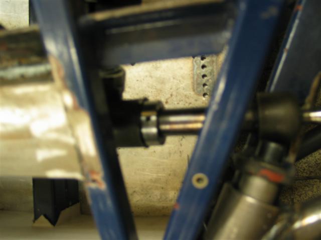

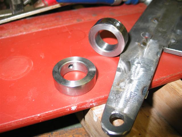

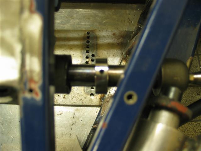

I've made the stops as shown at the cat motorsport site
i'll post a picture tomorrow

Here are the pictures
