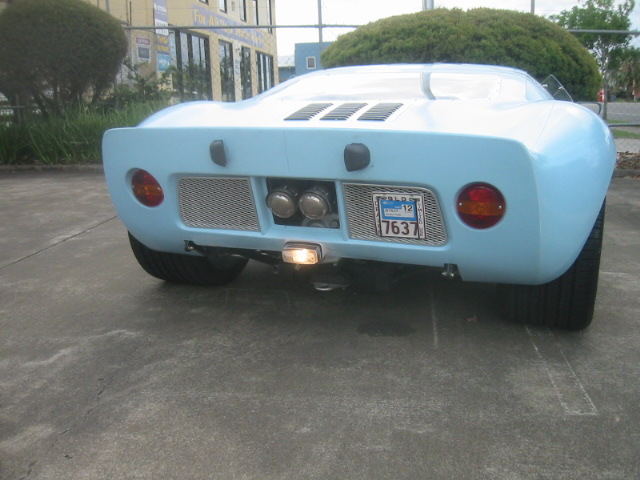

The only picture I have is when I draped the body over temporarily before it was strapped to the roof of the garage whilst I work on the car.
It does not give much away as to the suitability but time will tell I guess...

Your photo shows a little bit of the footprint those huge tires are making. Thank you for taking the time to post that shot for me.
Keep going with your great work. Those rear tires are awsome! Wow.

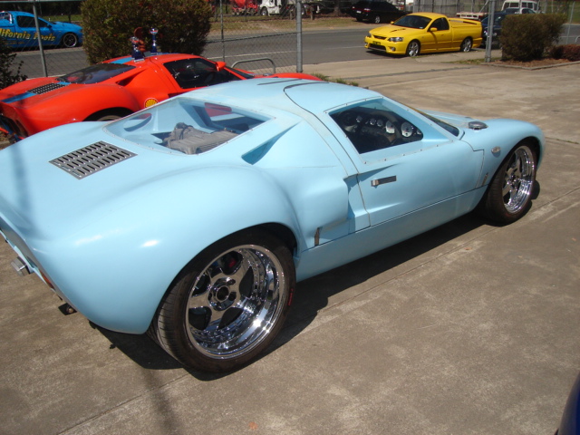

Hi,I have 335/30x18 on mine.Only issue is road noise on certain surfaces.
Cheers.

Hoppy,
Do you have any issues with your clutch with those big tires?
PS: What is that yellow pickup like vehicle in your last picture? Looks like it has a Mustang frontend on it, with a pickup box(????).

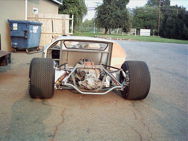

I currently have Avons mounted on 15 X 14" wide wheels and I personally think thats a nice look with the bodywork.

Gary,
PR at GT40 Australia uses 335s and his clutch is over 2 years old and he competes regularly.
The yellow car in the background is PRs 2006 Ford Falcon ute.
We still produce Falcons in OZ,a ute is basically a sedan from the b pillar forward and a pick up at the rear.You can get all the luxury (leather etc) in a work vehicle that will fit in a shopping centre car park.
5.4 lt(260 kw) with 6 speeds.
Mark,
The Tornado is a turbocharged multi port six.
Hoppy
