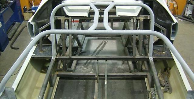

Hi Murray, there is one sitting in my garage if you want to take a look, and take some sizes, i will give you a pm with my tel no. Andy

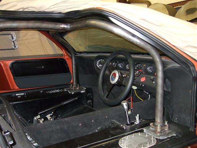

Mine is not a GT40, but I do have a SCCA legal cage for the Lola. One thing I noticed on the cage that you showed is that those foot pads where the bar mounts in is woefully inadequate, IMHO. I think they should be tied into pads with around 80-100 sq in of area and if possible, welded in place. Mine you can have a look at by clicking my build thread in my sig.

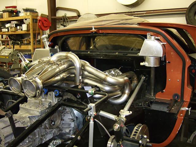

Julian, thanks for the heads up. What a fantastic job you have done on your re-build! Very well done, I just hope mine turns out half as good. Couple of questions, did you have a fuel tank specially made to fit round where the bar comes down into the side pods, or are they shorter than usual? What fuel caps did you use, where are they from and how much.!? I have to do some cutting out as I have no opening on my KVA on the front clip.
Well done again, she is a credit to your hard work.
Hi Murray,
Thanks for the kind words! Re the fuel tanks, on the GTD there is already a gap between the chassis 'sides' & the fuel tanks to allow room for the coolant pipes/gearchange etc... I found that by modifying the coolant pipes everything fitted nicely... (just!). I bought the roll hoop to the floor of the chassis to comply with RAC regs.
I fabbed the filler caps using a Mocal screw on cap from Merlin motorsport (ISTR about 15 quid each). I've posted a couple more pictures on my build thread that I hope may help. http://www.gt40s.com/forum/gt40-buil...completed.html

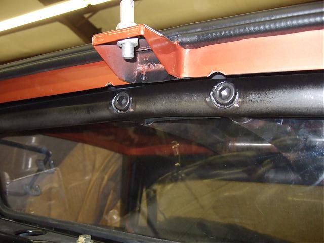

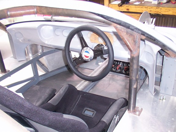

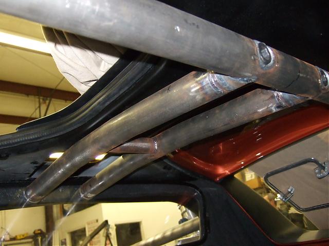

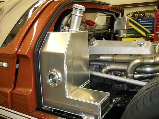

Here are some pictures of work in progress of the roll cage that I'm installing in my SPF Mark II. It is similar to what I have seen in several original cars but they were all very different. The main hoop is permanent but the front hoop and center member are removable. What isn't shown here is the rear braces that will go from the main hoop back to the rear shock towers. Should have those in place in the next week or so. You can also see the "Holman-Moody" style dry sump tank that has been built.

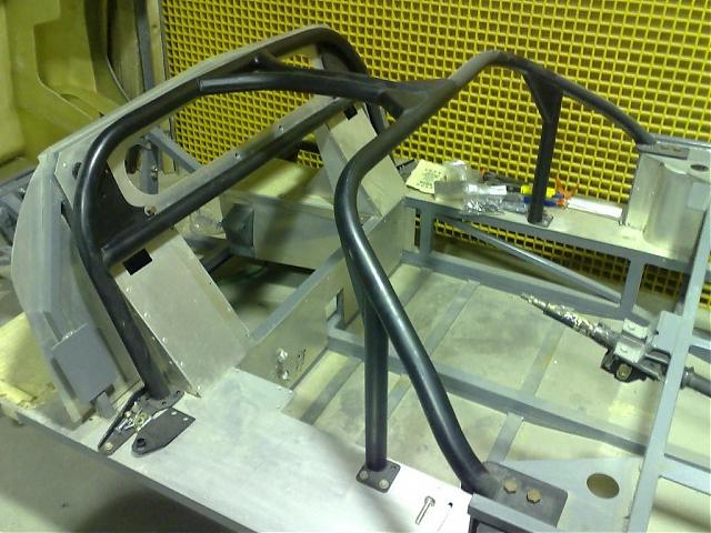

Still after Rollcage pics?
Took this pic not long after I got the car.
This is the 8 point cage from Roaring Forties. (Two rear bars not shown)
Hope this helps.

Yes. It's fair to say that my dignity is most certainly lost entering the vehicle!
The cage will have to come out for registration purposes. I will however re-install it after that. My spider is secured with RivNuts across the front, and is therefore removable to allow this.
The other issue is with my elbow and that upright. With the gear lever located near by, there may well be a few issues with this.
Good luck with your design.
