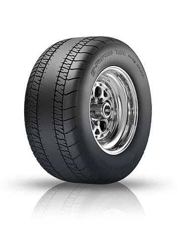

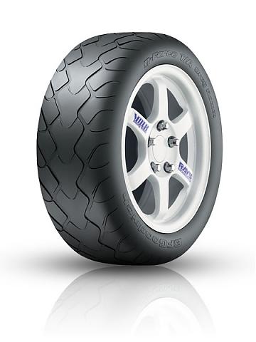

I have decided to take a different approach to tires, in that all I had asked in the past had come up with about the same info as on this list. My criteria for finding tires was based on the rear tire. I would like to have one like Bill D., but I don't have a Gulf flare rear clip, not to mention my wife is now in the market for a new car. Her 10 yearold BMW 5 series is about to give up the ghost. So I have to start making sacrifices for this year(hopefully this year only). So I am limited to one set of wheels. So all I have is about 14" of space to fill up. What I wanted was something along the line of a 315-335 type tire. I didn't relish the thought of driving around on tires that were not legal for the road. So I asked a few of the members what they were using(Bud, Roy Cobb, Fali, and Foowowee[Mike]). I got the typical answers that are out there. One with 17", one with Blue Streaks, one with two sets of tires and wheelsbut not sadisfied with his street tires(BFGs with a 295 rear). One however was different, and mentioned a tire I had not researched. Believe me I researched "almost" every brand out there. Mike told me of his Nitto tires. I Googled them and found them at Discount Tire and they have to send off for them out of Ohio. Nitto make a drag radial in their NT555R 325/50R15. What I also found from Discount was that BFG makes a G Force T/A drag radial as well in a P325/50R15.
The Nittos have a NT450 225/50R15 114V, but it is in a different style tread pattern. The closest they have in the same tire pattern is a 275.
The BFGs 225 is the same style, but it too comes in a different tread pattern as shown in the photos below. So here are the numbers on the tires I found on the manufactures list. They are a little different than the "List"
Nitto NT555R 325/50R15 114V
Dia.-27.9
Width-13.11 on 9-11.5 rim
Tread Depth(32nd)-5.0
Tread divided into 4 sections minimal groving in a slight arrowhead design
Nitto NT450 225/50R15 90V
Dia.- 23.86
Width-8.94 on 6-8.0 rim
Tread Depth(32nd)-9.7
Tread in an arrowhead design.
Price mounted and balanced-$658
G Force T/A Drag Radial
P325/50R15
Dia.-27.9
Width 13 on 10"Rim(9-12"rim)
Tread depth(32nd)-5.5
Tread(TT,DIR) in 3rds with outside 3rd treaded, middle slick
P225/50R15
Dia.-23.9
Width-9.3 on 7" rim
Tread(NT,DIR) in a wavy design
Price mounted and balanced-$757.96
Mike told me he loved the way the Nittlos handled. Don't know much about the BFGs. They are a different compound than the regular T/As. Does anyone have any info on these tires?
