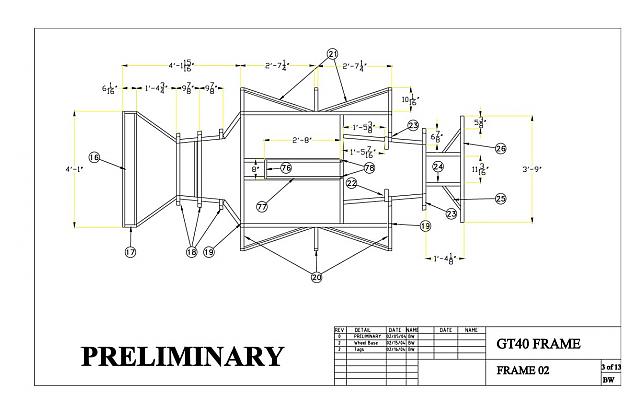

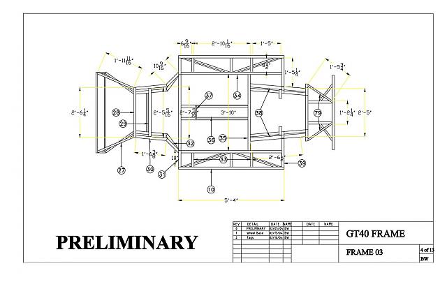

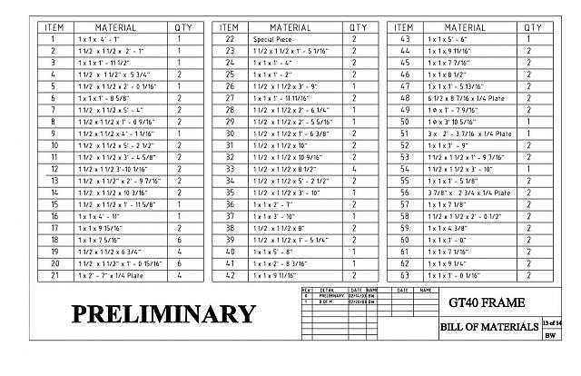

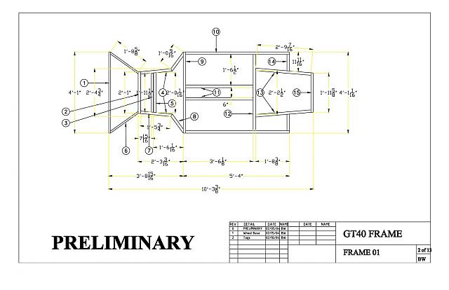

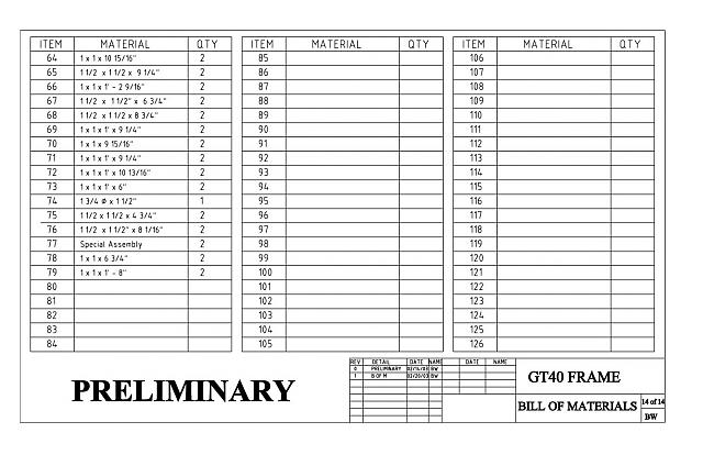

Hi guys
I found these on the web years ago, I don't know were? I cannot guarantee their accuracy but they do look ok.
Hope this is cool with everyone, just trying to help a guy out.
Regards
Chris.
