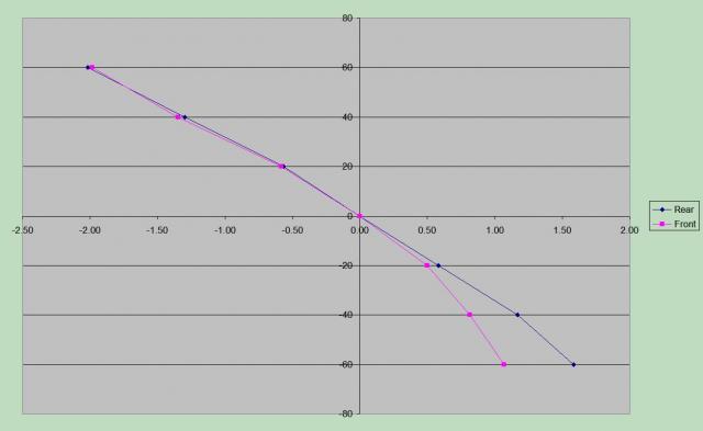

Anyways, don't have data on a new Ford GT, but have mapped my suspsension on my GT40 replica.
Front and rear camber curves attached. Don't know how well it works yet on the track. Drives nicely on the road, but won't have any real track testing for a few more months yet till decent motor is built and car is painted. I'm aiming for a total vehicle roll angle of no more than 2 deg at max cornering (say 1.2 - 1.3 g lateral acceleration).
Positive vertical axis = wheel bump travel (Zero point set at chosen ride height)
Horizontal axis = camber

I've only got limited experience with fooling around with camber. My last competition car had strut front end and live rear axle. All I could do was increase static front camber until thermal imaging of front tyre showed even temperatures across tread. Ended up with 4 deg front static camber, but that was only with 205 wide tyres.
GT40 has 235 front and 275 rear tyres, so will have to go easier on static camber. Then again, shouldn't need so much due to dynamic camber of double wishbone setup. Looking at my graphs, if I limit car to 2 deg roll angle, will only need 1/2 degree or so static neg camber in theory to keep wheels upright. Of course, it's not that simple, so my only way forward is to wait till I can test it and see what it feels like (under or oversteer)+ measure tyre temperatures. And then of course it comes down to corner speeds, never mind everything else! GPS analysis software should help there, as of course does the simple stopwatch and lap times!
