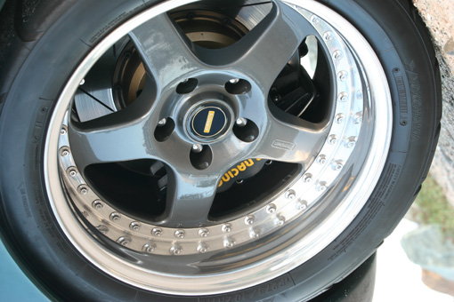

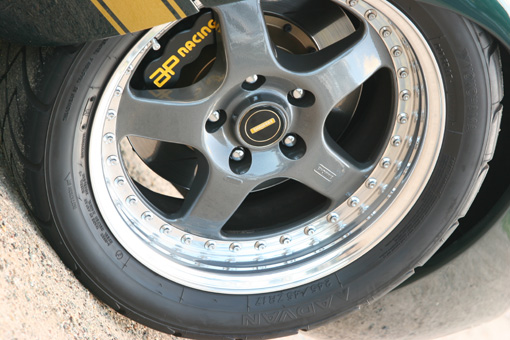

Unfortunately with the cost of the AP racing brakes, 13.5" rotors (front) and custom bracketry I will be out of pocket about 8K, but it has been fun and it will be different. I should have a lower pedal effort as well (larger disc diameter) so that will be one plus (I'm getting old!).
Jason,
Been there done that.
330x32 AP rotors and 6 pot calipers fron and rear.
