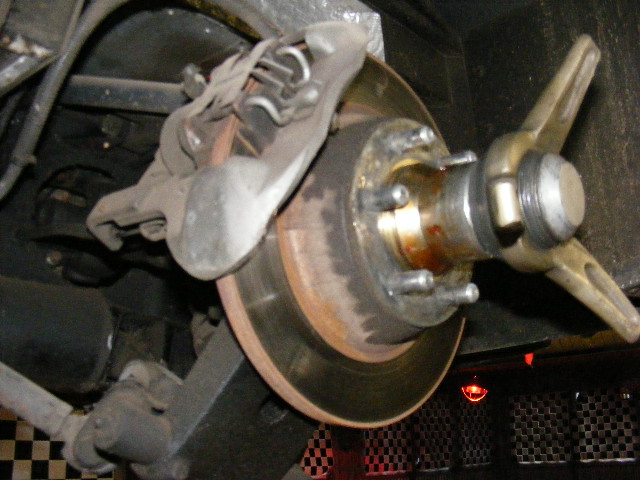

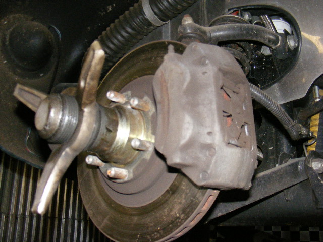

Anybody recognize these brakes ?
I need new rotors and it would be nice to find them on a shelf. Thanks for looking:)

Thanks...I just posted here because there are so many UK members and they are UK brakes. They may be (duh) AC
Johan:
That clip on the front looks like AP. If the are AP the should have some numbers etched on the castings some place on the underside or near the bores. AP numbers always begin with CP and then a series of 4 numbers and a dash followed by numbers and letters. Feel free to ask will help if I can. Dave
The fronts are not Princess Calipers, I have a set of those in the junk box and just had a look, the princess calipers have 2 hydraulic hose entrys and the bleed nipples are between the pistons.
They could be Jaguar as JacMac suggested, as the Jag IRS had solid rear discs. The other thing the rears could be is Renault 5 or Fiat 12x series as they too had solid discs.
Front calibers looks very much 2wd cossie ones, but they are propably from bimmer (in -87 M6 i saw those when i built one), there is small diffirencies in caliber casting.
Self locking pad rods and squeel spring are similare as cossies.
