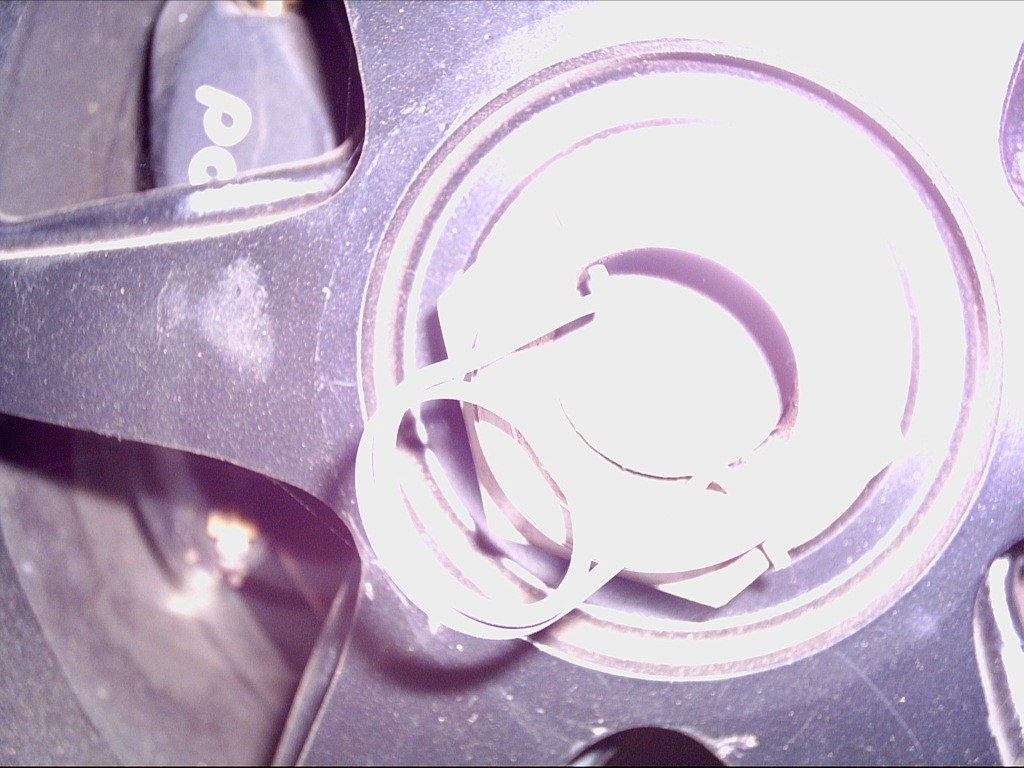

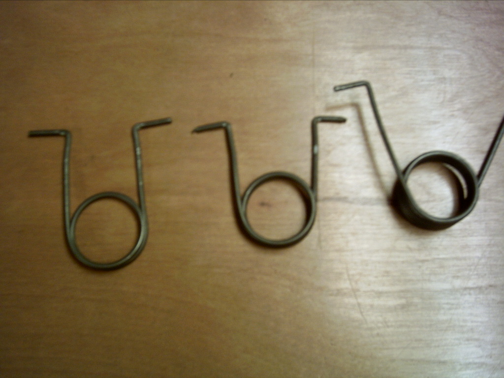

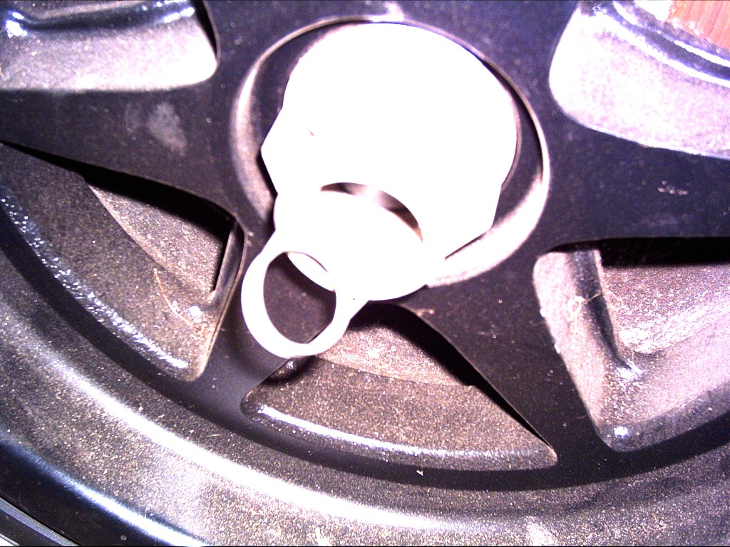

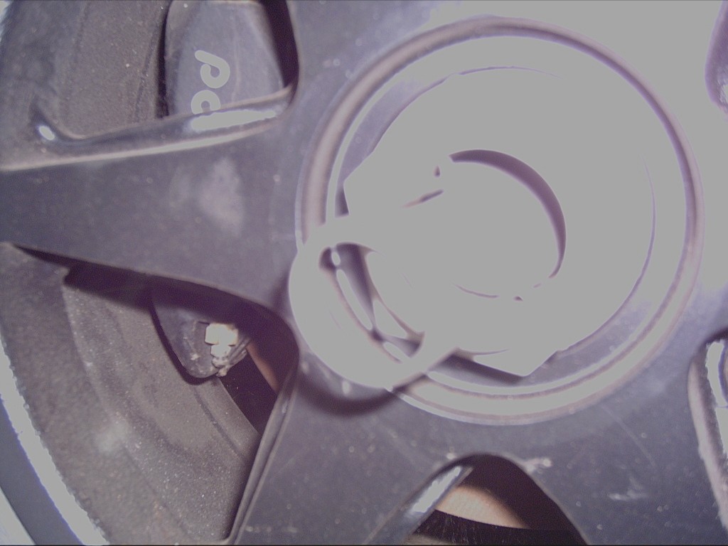

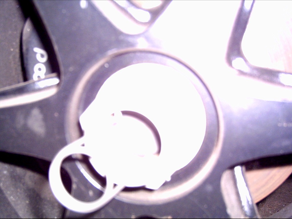

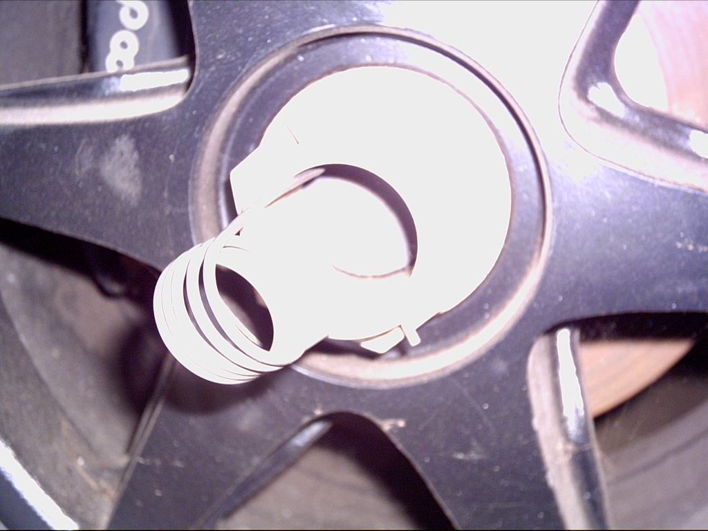

Here are the few I had time to knock up with a little time today. They are not totally perfect, but give an idea. I tried all three in my wheels and the 2 1/2 turn fit the best.
I made a 1 1/2 turn, a 2 1/2 turn and a 4 1/2 turn going a little over board but it gave me an idea of how they fit.
The 1 1/2 turn is just too flimsy, and the 4 1/2 is kind of clunky to fit into the snout. Here are some photos that show some preliminary results.
I will try and do a 3 1/2 turn and see how that one works. The middle clip in the 3 is the 2 1/2 turn clip.
