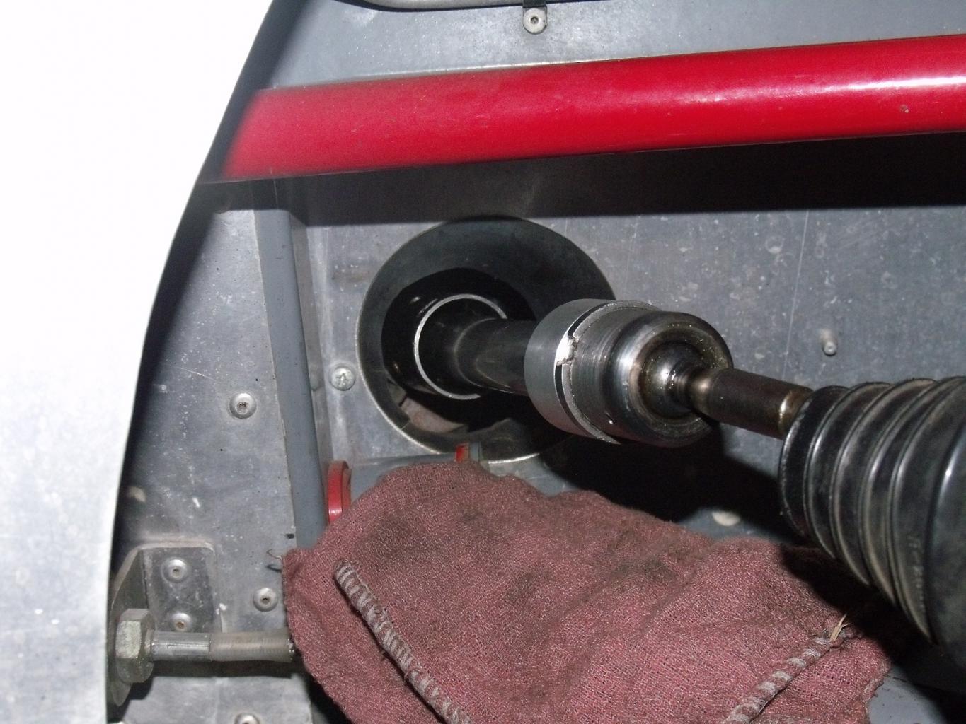

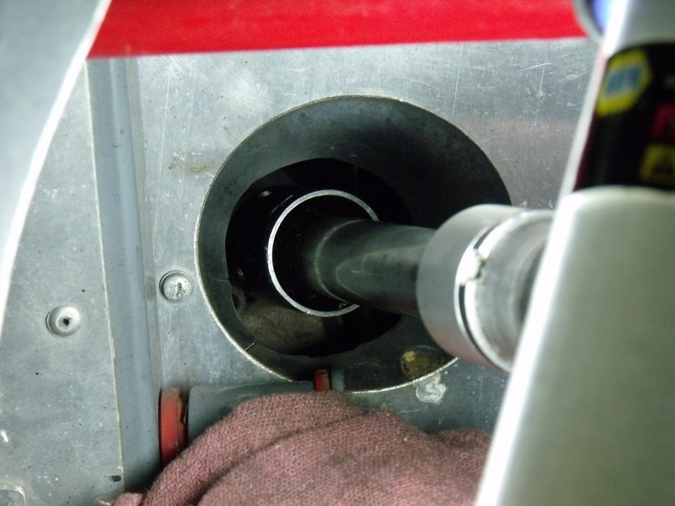

Hello, Does anybody know what 1st gen Roaring Forties used for thier steering racks? It was built in 1999.
My car is making a horrible clunking noise when driving. Upon inspection I found the the left side inner tie rod end moving about. I pulled back the boot and pieces of plastic fell out.
The inner rod is tight. It's the rack shaft itself that is moving because of the spent bushing. It's righthand drive. Any info on this will be greatly appreciated

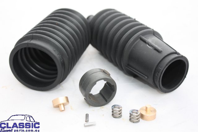

I'm pretty sure Patrick is after the plastic inner bush.
This is a pic of an Escort's bush, but both are very similar.
Hi Patrick
As with John, if you cant find any let us know.

Big thanks to all that replied. I'm still looking for these parts in the U.S., But it's looking grim.
I'm on vacation in a few weeks and want to drive the wheels off this thing before winter sets in. Thinking of a trip to Watkins Glen. They do "Thunder Road" tours two times a day everyday except when they have events.
$25.00 gets you 3 laps around the long track. Did it in the Porsche and it was a blast! If the pace driver is in a good mood, you can wick em' up pretty good.
I'm open to all and any who can supply or lead me to this bushing. I've noted already said suggestions.
