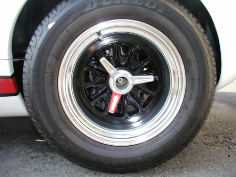

#2) Definitely a difference. The first photo below is a "Cobra" style
Halibrand and the second picture is a "GT40" Halibrand (original). The
easiest way to spot the difference is in the curved shape
"champagne glass" configuration you get with the "GT40" style.​
