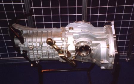

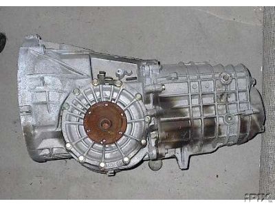

Still confused about all the different gearboxes mentioned.
Brett said that Ultima use the Getrag from Porsche Boxster S, but the pictures of one for sale
Boxster S on ebay
do not look like the ones lined up at Ultima
Ultima Getrags
or the one Julian West photographed on the Ultima Stand
and not like an 01E
O1E box
The ones at Ultima appear to look like the Type 450 pictured on Getrags website
Getrag page
I spoke to Ultima who have told me the Getrag box they use is from the 996 (but didn't say which 996), but that is not listed on Getrags website, or is 996 just latest incarnation of 911, hence why the Ultima ones look so similar to the Type 450, listed as for 911. Ultima also told me that this is invertable (like Julian saw) just like the G50 (their other option) using same mountings but different brackets.
Reference previous info from Brett, Mark, Julian et al. there is obviously still much confusion (well I have much confusion anyway) about which box is which. Does the Getrag Type 815 mean the same thing as the Audi 01E. Is the Porsche G60 the same as Getrag Type 256 or 448 or 450 ???
Has anyone a proper breakdown of the translations between Porsche numbers, Audi numbers and Getrag numbers?
If the Getrag Porsche box (996/ G60/ Type 450?) is invertable, is the Getrag Audi box (A8/ O1E/ Type 815?) also invertable
Picture of Boxster S box on ebay

Picture taken by Julian on the Ultima stand

Re: Getrag Transaxle
Lee,
If it is the transmission out of the 996 then if you buy it off Porsche... it would be cheaper to buy a Quaife unit [img]/ubbthreads/images/graemlins/cool.gif[/img]. These have also been installed in Ultimas. What I do know however is that as said previously Porsche prices are horrific.. I asked one day at a dealership in Hertfordshire (the one up the road from Dave Champ), they wanted £11.5K +VAT for a Turbo box, but said I could have £1K if I wanted locking diffs!
NFAuto will sell you a getrag box for £3.5K+Vat they quoted last year... but the Ultima site used to be priced at this, but has gone up closer to Porsche prices, I've just seen! This would make Quaife a better option, if you are someone who is prepared to give Ultima that kind of money. ANy way I am rambling, its time to go home and the garage is calling.
